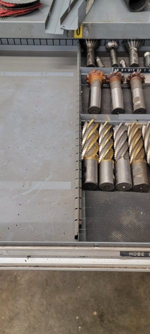

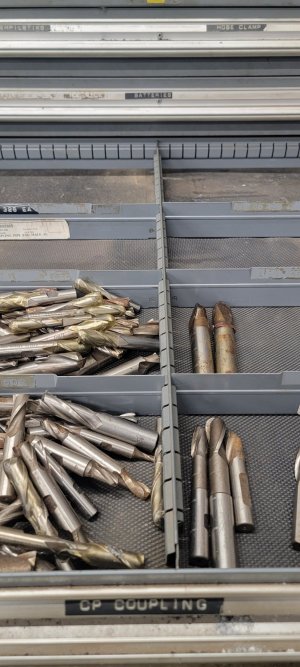

@Dan Dubeau mentioned free treadmills tonight. Just so happened that I was lining the vidmar drawers with treadmill belting tonight so I snapped a few pictures. But first I had to test the fridge.
Sure enough, a 30 just fits.
Doing 1/2 drawer at a time.
Tedious task but way better with the thin belting in the drawers.
Every time I go to the dump I find at least one treadmill and cut the belting off for liners and such.

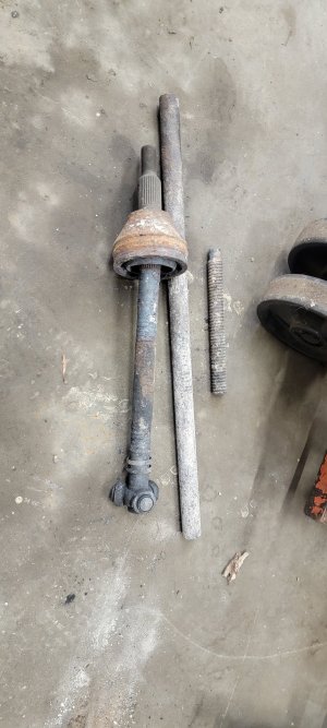

Axle shaft, torsion bar, and a ballscrew straight out of the woodstove. 20230428_184128.jpg

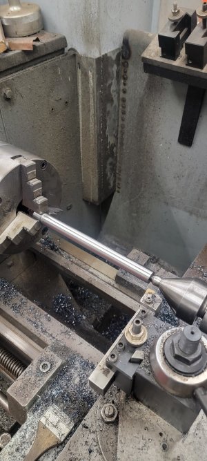

Able to machine the torsion bar, which should be 4340 chromolly, but couldn't get anything but a terrible surface finish no matter what I tried.

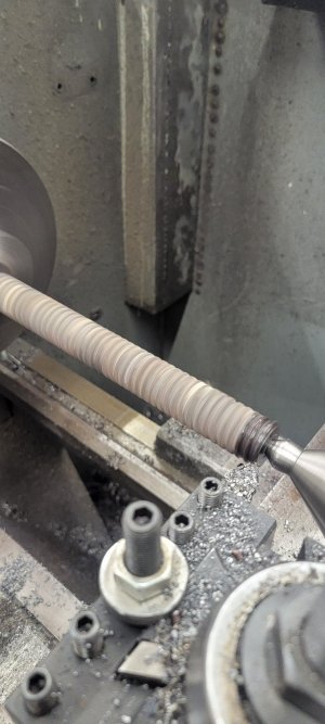

Going to try the ballscrew next. It was super hard before. The last ballscrew I machined was softish on the ends.
Just playing around, need a pin for a job tomorrow. The torsion bar isn't going to work. Machinable but terrible finish.20230429_003221.jpg
the ballscrew machines pretty nice after the woodstove treatment.
