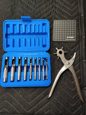

I just bought a punch set (left) to use with the punch my father-in-law gave me years ago (he had a saddle repair shop). I'm using both to punch holes in fabric before screwing it to a wooden frame.

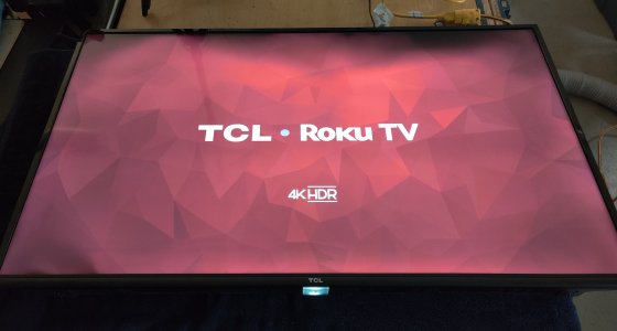

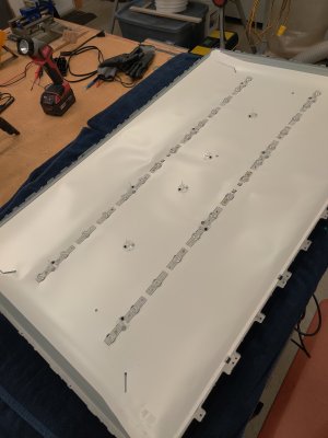

Today I replaced the LED backlights for a 5-6 year old Roku TV. Bought the 4 strips through AliExpress. Tried to find a more local source but the model of lights for my TV were always out of stock.
This was my first attempt at such a repair. Pretty straight forward in the troubleshooting and repair steps. There is only one step I would do differently next time - cut through the reflective paper vs removing it to get the LEDs.

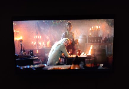

Now, I will remount it to the wall, reconnect the set top box, and see if the picture quality is acceptable.
Picture is acceptable.
There is a little dark shading that can be noticed at the edges in a couple spots. The imperfect reflective paper removal/re-install is likely the cause. But not enough of an issue to distract from the image.
IMO $40 repair is a success.

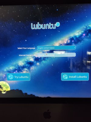

After several years of the computer sitting idle I finally decided to do something with my 2010 iMac. This is a fantastic piece of hardware that recently I thought of getting rid of because it was so limited in it's capabilities. Thanks Apple. Today after installing Lubuntu (lightweight version of Ubuntu) new life has been given to this computer. Looks good, runs very snappy like the old Mac OS days, and I have a software OS that is supported.
There was a few hurdles, as always, but a little perseverance and a lot of patience got it done.
Cost = free
