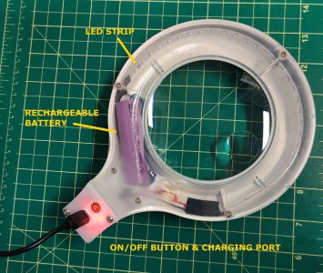

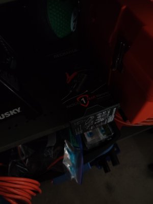

The magnifying work lamp that I recently replaced was sitting with a burnt out fluorescent bulb on a work bench for several days. New LED work lamp was a huge improvement in every way. So now what to do with this one? Thought of modifying it into a cordless rechargeable lamp. But I didn't need a full sized magnifying desk lamp for anywhere else. The magnifier was the part I wanted to make use of again. So I decided to take it a step further:

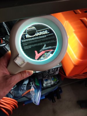

A handheld cordless rechargeable magnifying inspection lamp
🙂 (patent pending):
View attachment 80552 View attachment 80553
Built from the guts of a $5 rechargeable LED fixture and parts from the original magnifying lamp:
Puts out max 200 lumens but has 2 light levels:
Turned out better than I expected. Better viewing size and more convenient than using my phone with the magnification, especially if my hands are dirty or if I am wearing gloves.
