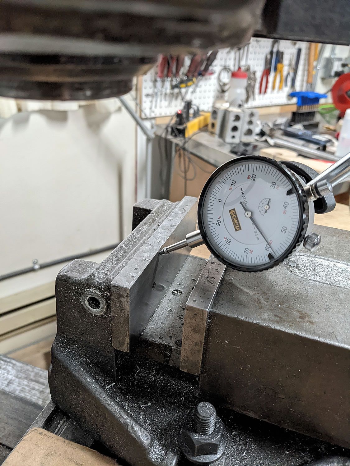

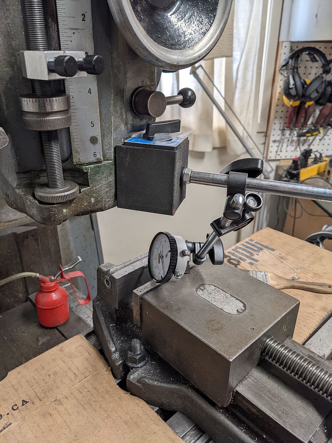

You can sort of set it up like this for tramming a vise. Yes, there's cosign error, but you're not actually measuring anything absolutely, just a relative measure, so what does it matter...

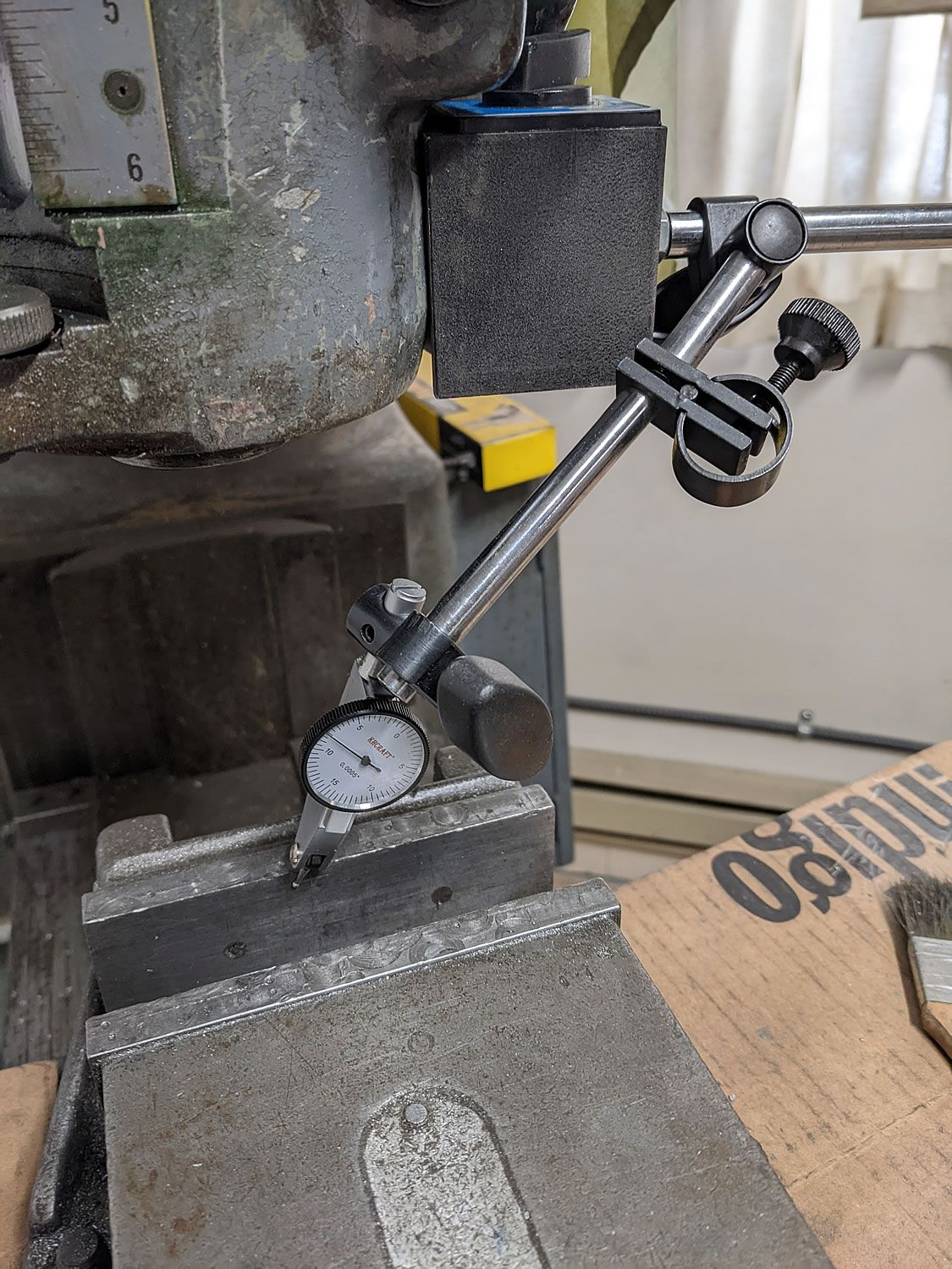

You are right IMO. What you are really doing when you tram a vice is aligning the rear jaw with the x axis of the bed. So it really doesn't matter squatt how you measure it. That said, am indicator on an angle reduces the effectiveness (call it magnitude of measure) by the normal result of that angle. So you are always better off with an indicator system that is normal (perpendicular) to the axis of movement to maximize the amount of movement you get on the dial readout as a result of any misalignment.
In this respect the last photo is better than the first two.

For tramming your vise you have a test indicator so just chuck the end of it in a collet (red straight Arrow) and turn it so you can read the dial. I put my mill in the back gear so the spindle cannot move easily or you can put the brake on or lock on...what ever you have. The pointer end can be adjusted so it is in better position to touch the face of the vise. Move the indicator onto the vise so you get a little reading, tram away.
