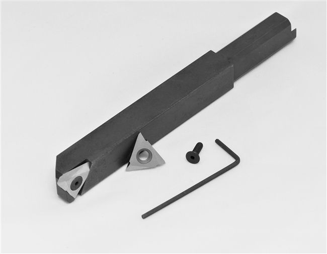

The next good decision I made was to buy a threading tool. Insert type.
I did buy a few carbide insert tools but never learned to like them. A few years ago I ran across this kit.
I never looked back. This tool cuts the best threads I know how to make. It uses hss inserts instead of carbide. So you can cut slower and still get a fantastic finish.
I also have one of these from Mesa tool. It is almost as good as the Warner but uses carbide inserts. I use it for most of the threading I do and I save the Warner for those times when I need the best thread I can make.
Lots out there. This is the one I got here
As I said, it is good, but it is large. Sometimes that makes it a bit of a hindrance. I like the ones @Susquatch got. They look good.
