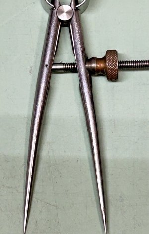

Part of a local buy and sell group haul of old tools I got. It's quite tiny. Anybody know how that broken screw is retained in the arm? There is no sign of pins or anything. It is designed to pivot as the angle changes which gives the impression of a ball and socket. There is also a relief in the arm to accommodate a tight angle.
I tried pushing it in and turning it. No joy.
I can replace the screw but I need to get the stub out first and then put the new one in.

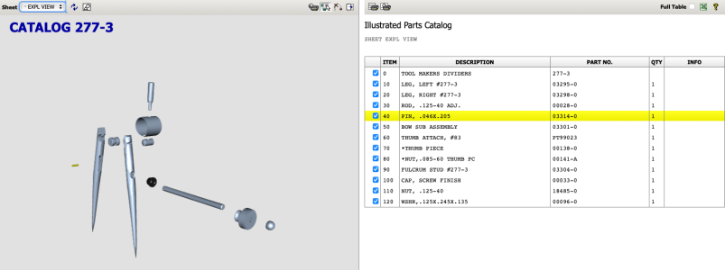

But in cleaning it up and polishing it, I discovered that is a Starrett! WoooooHooooo!
I think @thestelster is still in the lead at 52 Starrett tools, but I just got one tool closer!
Now I have to fix it! Including the spring it is just 2.75" long.

It seems that there are only a few possibilities. It really has to be either a pin or a ball.
Can you show a picture from the outside of where the broken end is?
My money is on a pin, peened over, and blended in. Either that, or magic.
See if a pencil, or some other marking object rubbed across the area will reveal a witness line. Sometimes there might be a faint line, but it is possible to blend them in and make them pretty impossible to tell.

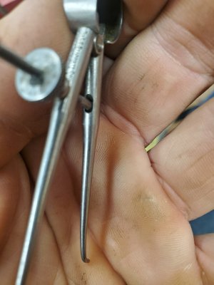

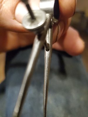

This is mine from the backside....
And a shot from the other side around the pocket. I don't think it is a ball, unless the sides are ground. It pivots freely, but doesn't rotate at all....

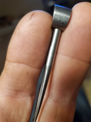

Just had a look at mine that I inherited from my father. Same little Starrett which shares the case he made with a Moore & Wright 1” and an unidentified 2” mic.
I can see what looks like a pin in there but I can’t see how they got it in there or whether it’s integral to the screw. It could be pressed into the leg but I can’t see any witness or plug in the leg. Maybe something like a watch band retainer but ‘way smaller??
If they were being very clever they could have drilled down the leg from the top then fitted a plug with a feature to retain the screw cross pin but again I don’t see any witness marks.
