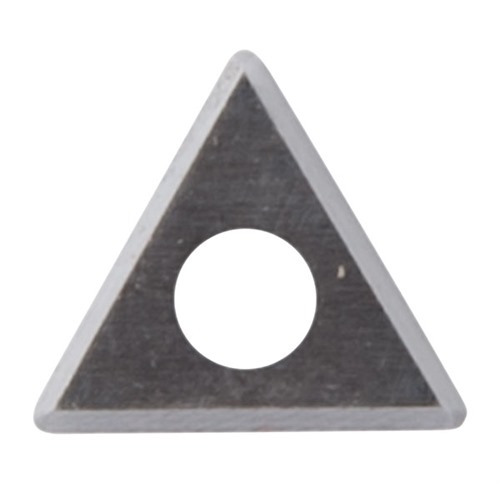

While I occasionally use hand-ground (off-hand?) HSS bits, I mostly use HSS (T-15) inserts from A.R. Warner; but love the “Aluminum” inserts as well, and also Diamond Tool Holders with Crobalt bits.

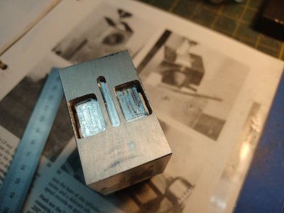

3/8, sure give it a go, even 1/4". But I just chain drilled 4 1/2" series of 1.5mm holes in al/ci with no centre punching or spot drilling using 135dg split point drills. To me that and smaller is hobby stuff that is not going to get ground properly by hand (IMHO). Holes were on 1.6mm centres (using DRO), then cleared out using a Proxxon with an ancient dental burr. The tip has to correct or you are hooped. I'm 12 hours into the part, certainly not going to faff it up for the sake of a $1.50 drill bit from AE.
LH steam passage was with a mediocre drill, rh was with a proper one. slots are 1.5mm wide, 0.5" long, 0.031" from the edge.

The A.R. Warner stuff is great. The only source that I've found is Little Machine Shop and they no longer have DCMW inserts. Where do you get your's and how much?

I have ordered direct from ARWarner many times.
Brownells also sells them. Don't even try to understand their nomenclature.
I buy direct from ARW, prices & selection here. You can purchase from the website, but I usually build a list and then give them a call: that way you can ask if they have something that they don’t list. However, last time I asked they didn’t have any DCMW - maybe if enough of us ask they’ll grind some for us.

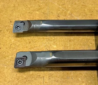

I admit I also got mine on eBay, $18 for the 8mm (1 insert) and $40 for the 10mm (10 inserts):
The 8mm bar (top) has a T-15 insert; the 10mm has carbide.

The DCxx inserts allow one to get closer to a live centre than CCxx ones so they're often more convenient when facing the ends of stock. Also, their 55-degree angle is the same as Whitworth threads.
