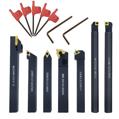

For those considering purchasing some inserted tooling, a set like these is definitely a good start.
I have purchase a LOT of this type of tooling, both off eBay and Aliexpress. They have all been good quality tools, well made with hardened shanks and using standard inserts and fasteners. None of it has been junk.
