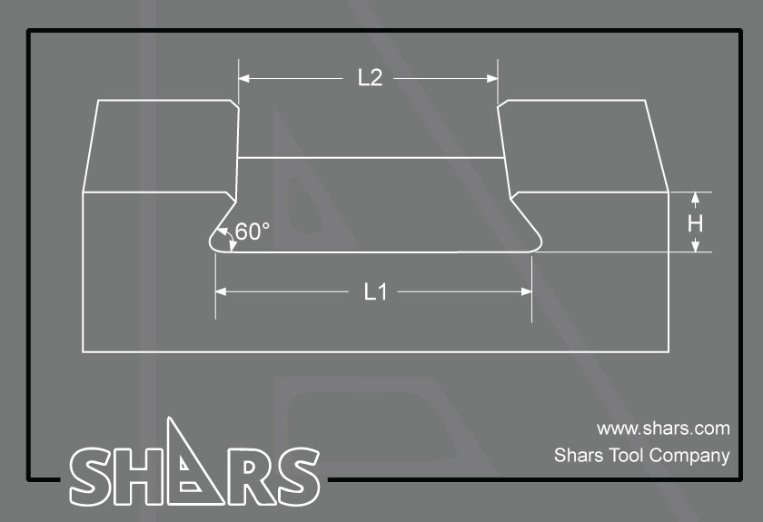

The Shars website publishes this...
H 0.386
L1 1.687
L2 1.382
I'm beginning to doubt that what I have is actually 60 deg. I'll try @RobinHood's website with some end mill shanks as pins tomorrow.
Perhaps check my math here. Assuming A and B are correct for the ASA tool holder then (A-B)/2=Adjacent side while D is the Opposite side so arctan(Opp/Adj) = dovetail angle.
(1.64-1.37)/2=0.135" and D=0.383" so ArcTan(0.383/0.135)=70.58 degrees. Somehow that strikes me as wrong? You'd think they would make that angle 60 degrees.
Right you are. WTF.

I'm going to guess just like the shars drawing that these are all sketches and not mechanical design drawings. So the dimensions are approximate without taking into account corner radius or bevel.
Agree. One stands a slightly better chance with the theoretical point to point diagram of the Aloris/Dorian sketch, just leaving the radius which probably isn't too critical give the generous chamfer of the TP male. . The Shars diagram is messed up, bad dimensioning practice.
Back to the angle discrepency, I have seen plenty of references to 60-deg Aloris, so something is not right. Is the chart in error? If it was a special angle that precluded common commercial cutters I could see it as an attempt to keep buying the compatible brand. But seems like people swap them on & off with other systems all the time & are predominantly 60-deg?
I got the pic from here

Yup, one of many examples stating Dorian or Aloris TP with 60-deg dovetails. That would infer dimension diagram in PennTool link is bogus.
