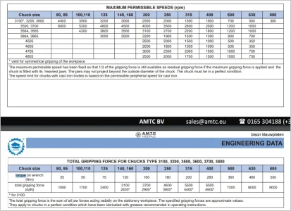

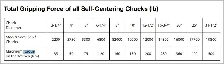

But do you know what torque value is required? I don't. I guess it doesn't really matter that much, as long as they're all even.
Actually, no I don't. I've always assumed the small t-handle was deliberately sized to prevent overtorquing the cam bolts. Being a big fellow, I've always been gentle with them.
I have not assessed the info @PeterT has provided above yet. This will help me decide what size of torque limiter to acquire.

I've heard that the tommy bar T-handle chuck key design is partially intended to limit excessive Gronk torque. The chuck specs seem to support that.

I can't really make heads or tails of this info Peter. I think these charts are all referring to the torque on the collet tightening mechanism - not the CamLock Studs. The other chart you copied from GTS is similarly suspect.
On a related topic, I looked at the bison catalog you linked to and could not find all the different d1-x mount choices for collet chucks. Have they dropped those?
