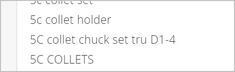

I thought Shars had a system too. Strange, when you type in 5c it shows in drop down but never really comes up. And the regular chucks all out of stock.

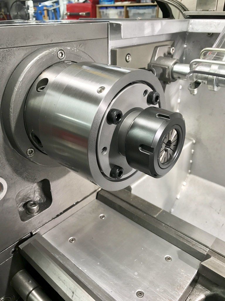

Here's my 5" Bison Set Tru when it was on my Emco V10p. Was able to dial it in pretty close. If I was needing collets, I'd definitely want a set Tru type.
I made the set true backplate from an old pulley. When I transferred it to my new V13, i bought and modified a D1-4 backplate.

ER40 collet plate married to a beefy D1-4 adapter
I was not able to measure the spindle runout. I don't have anything precise enough, to be honest. The V10p was a threaded spindle with a locking collar. The V13 is a D1-4. The V13 results are similar. The threaded spindle of the V10p was remarkably repeatable, where the D1-4 actually takes a bit of care .
Forget the spindle though, that chuck is dead nuts on when you consider i was measuring 4-5"? out from the jaws. For that reason, for myself, I don't do enough multiple parts to really warrant a collet setup but if i did, I'd want a set tru for sure, no doubt.
