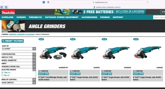

I have three Makita's, a Dewalt and a Milwaukee all rat tails and they are not the entry level tools. None of them have a brake on them. What brand/model has a brake?
Makita make some grinders with brakes. not sure about the other brands I haven't looked.
cordless
$239 on amazon :( seems like a lot.
Oh found another one:
$149 that is better. Dewalt has a few I noticed too.
corded...

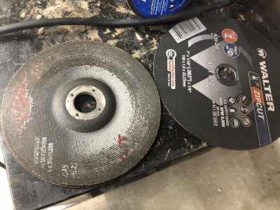

Ok, found a video on those 'walter' discs. At the 0:20 second mark they describe the 'backplate'. My cheap POS grinder has this as an integral piece I can't remove it. But those discs just 'spin-on' once you have then in place.

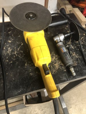

My Dewalt takes around 6-7 seconds to stop. It’s a DW831, I don’t see a brake listed on Dewalts website. Sitting side by side you can compare it with a die grinder. Also you can see the difference between a flat zip disc and the raised centre style. Anything that keeps it further away from fingers is a good thing
