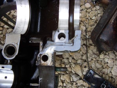

this is a picture of the aerovee, they do not use a seal (i emailed them), you can see the very slight left thread cut into the od

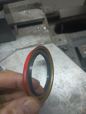

this is the oil seal that is/was used by great plains, National 6815, it has the right ID, is inexpensive, it is 6.35mm tall overall, thats the only issue. I think i could modify it by cutting down the height and installing it "backwards" to the conventional install (into a wheel shaft or whattever). I of course would need to cut it in half, but this has been done successfully by others. i think this might be worth a shot, that combined with routing the breather into the airbox and maybe ? i will need to get a seal and do some measurements to see if the rubber will end up where i want it

Im going to run out today and pick up one of those 6815 seals, see if i think i can make that work, not much to loose there.

I have a plan with the 6815 seal, me and my scruffy helper are on our way to try it out, I'll update in bit with how it went

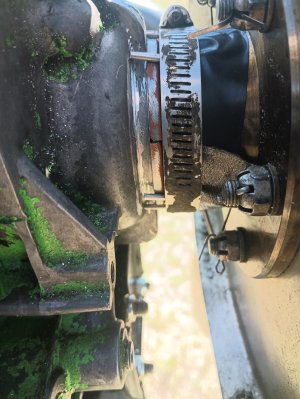

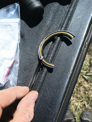

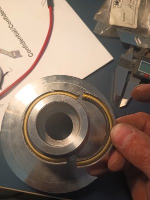

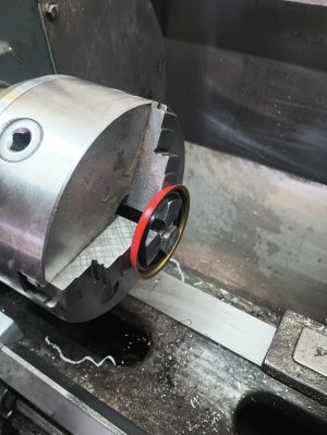

here is what i ended up doing, the 6815 seal is ment for a slightly smaller shaft (.5 mm), and is about twice as thick as what will fit on the straight portion of the shaft so it wasnt as simple as just cutting the seal in half and gooping it on, i turned off a portion of the metal shell, and trimmed the inner part of the seal, now im sure it wont work as well as it could with half the seal missing, but it will be much better than nothing.
Using the scrap hub i have, i played around and figured if i cut 2/3rd of the diameter of 1 of the seals, i could cut the another seal for the remaining 1/3, i could field fit it by trimming the metal shell with snips and filing, that way i could gain that extra bit of circumference with the second seal so as not to have either an extremely tight seal, or one that didnt cover the entire circumfrence.

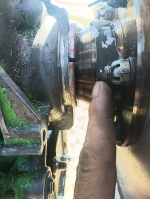

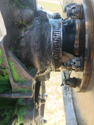

i used a hose clamp and some pieces of aluminum filler rod to compress the seal around the shaft (and hold it while the jb weld cures), the gap you can see without the clamp i can close up by pressing the seal down with my fingers, so i dont believe it to be to tight
gooped on the jb weld, the filler rods also help to make sure i have an 1/8 of jb weld on the seal, although i may go back in a few days, remove the clamp, trim the filler rods, and add another pass of jb
