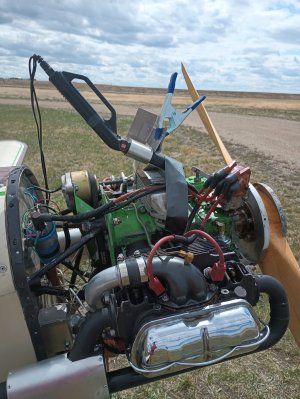

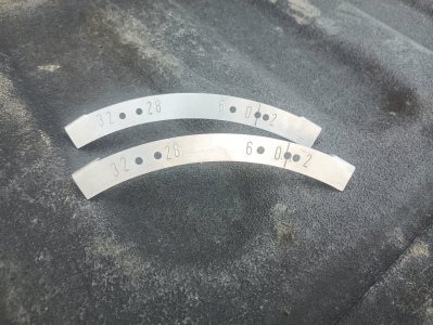

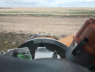

Came up with a new idea to time in the full advance, the original plan was to time off my marks on the back of the engine with the phone clamped to the timing light videoing, well cant see the marks from the phone where the timing light needs to go. I will need to time off the back of the prop spinner, made up a quick program and cut out two timing tabs to rivet onto the back of the spinner flange, i will have to make a pointer on site, and some way to clamp the timing light to the oil cooler im thinking.

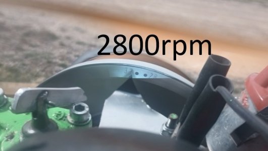

Well, a cell phone is not ideal to video the timing light, the frame rate is far to low, but i did manage to get some video and it did help me correct the timing.

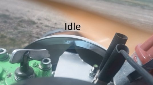

First full power static runs i did have some large bogs and flat spots, i was able to get the engine to run 2800rpm, i was videoing for these runs and managed to note the timing far to advanced, over 32degrees at full throttle, and what looked like 23-25 degrees idling 700ish rpm (the advance springs must be extremely light), full trot i should only be seeing 28 degrees. With the new timing tab i was able to set the static timing to 3deg'ish BTDC (from 6ish) , That small change made starting a heck of a lot easier, it also cleared up those bogs/flat spots and now makes 2900rpm. I did not video another full throttle timing run.
The video is a start/idle , this is a hot start with the timing at 6deg static, very hard starting, need a fair bit of throttle, and even though it is tied down very well, you can still see me sprint around to pull the throttle back. You can see how difficult it is to see the timing, its noticeable around the 35 second mark. With the timing set to 3deg static it will now start hot with 0 throttle, just a hurried walk around instead of the full on sprint.

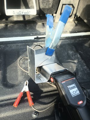

The goofy rig holding the timing light with my cell phone clamped to the front. You cant see but i have a "baby bessey" clamping it down, the tape just stops it from bouncing around
View from the cell, you can see the site made timing tab, as well as the cnc cut timing marker riveted to the lip of the spinner

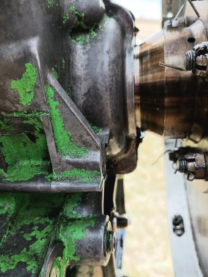

One of two problems i have to deal with now, the prop hub absolutely pisses oil, vw never used a seal, aerovee doesnt use a seal, great plains used a seal jb welded to the front of the case. Im thinking that if i can find some seal rope/rope seal i may sew it around at the base of the prop hub and jb weld it into place, or possibly make a holder for the rope seal and jb weld the holder in place. I think i made the clearances to tight and it has some kind of capillary action, vw probably didnt make that hub with .005 clearance. Anyone know where to get seal rope in the 21st century ? i think thats my best option, i dont care if it leaks some, it just needs to be a manageable amount.
this is where i have to stuff a seal in

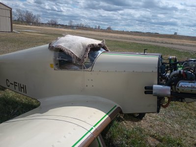

One of my wifes old sheep skins she told me to throw away....never throw anything away.....hopefully it will stop the tarp from buffing the heck out of the windscreen
Can you take that flange off without dismantling the engine ?
If you could, what about making a round seal holder with a flange with say 8 small screws or bolts that you attach to the front of the block, slop some RTV under it. There is probably a seal available, hydraulics shop, or getting one made isn't too bad, at least they weren't 30 years ago last time I got some.
i could probably get it off, but getting it back on is an issues, interference fit, have to heat it up to 450 deg to get it back on. So the re-install would probably cook to seal
some guys cut a something like a axle seal in half and jb weld it in place, i didnt leave enough straight shaft i think for something like that, either it needs to extend far to the straight section, or the seal would be running on the taper, not sure how well running on the taper would work with a standard rubber seal
i was thinking it might be possible to use something like this
i could put that around the base of the flange where it meets the case, tighten it around with some form of clamp, and jb weld the whole shebang onto the case
