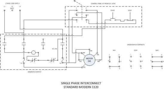

Gents
I was about to start a new thread on adapting the wiring of the contactor of my 3 phase (220V, 3/4 HP) SM 1120 to run the 1 phase (110/220) 1 HP motor that came with it but there's so much good background here that it's worth having it all in the same place. I have to say I was pleasantly surprised to find this thread here at home on CHMW!
@RobinHood , I have a question about what you said:
Just use two (L1 & L3) of the lugs of the contactor instead of three.
By doing this you bypass the two normally closed switches in the line between L2 and the coil. See diagram above. These appear to be the thermal switches of the two "heaters" and removing power from the L2 line would appear to disable the magnetic coil.
I have read in other resources a suggestion to connect L1 & L3 as you said but take the output from T3 and connect it to L2 (thus powering the coil) and connecting the output of T2 to to contact 1) of the drum switch.
I like this approach because it is the least invasive mod to the existing wiring. Does this make sense or am I missing something here?
That is correct.
That is why AB tells us to connect “X2 to L3“ to power the coil.
Now the coil is powered again; plus the latching coil circuit is protected by the motor thermal switches and is de-energized should the motor overheat and thus open the contacts.
I don’t think your “START” button will work in that case as the T3 leg is only powered after the contactor at L3 is closed. The L2 side of the coil needs continuous power for it to energize / stay energized. The AUX contacts at 2-3 perform the latching of the coil circuit to keep all three main contacts closed.
IIRC, the drum switch on the SM1120 is not supposed to “start the lathe”. It is there to select FWD or REV only and to make sure the contactor opens (thus shuts down the lathe) when the operator switches spindle direction without first stopping the lathe with the “STOP” button.
EDIT: just came back from the shop; the drum switch is wired just like I describe above.

OK, I'm back!
I found some time yesterday to have a good look at the wiring and ring it out vs. the SM wiring diagram and I was pleased and even a bit surprised to find that it hadn't been modified over the years. WIN!
A little contact cleaner on the drum & other switches and everything appears happy and ready to convert to single phase.
I also identified the X2 line (not marked....). I will note that AB gave instructions on how to config. the mag switch for 1 phase but didn't mention the motor so a bit more homework was needed.
After sitting down with the SM wiring diagram and the motor connect data (Baldor) I came up with this connection plan:
The proof is in the pudding, it runs! Both directions! No magic smoke released either. :D
I honestly don't know if all motors are configured/labelled like my Baldor but it would appear to be the same hookup as @calgaryguy found for his and as @Brent H showed on his diagram. I also lucked in with the "heaters" because my machine was already configured to run on 220V so no searching for different heating elements needed.

make sure your 'motor starter heaters' in the AB switch are the right spec for your motor/phase. Thats something I had to change up.
Good point, I skipped over that one a bit quickly reconfiguring the wiring. I won't be using the machine for a while yet, at least the existing ones would give a very conservative safety factor!
Now, for the heaters and just to throw it out there for feedback, I have:
- A one HP motor/max 7.4A
- Bulletin 709, Size 00 magnetic switch
- Two relays (not open block type)
This points to Table 13, full loads less than 7.63A so it's looking like I need a N28 heater element.
For ref: AB Bulletin 815
Make sense?
Tks.
D :cool:

Just to close the loop on this, I ordered a pack of two N28 heaters from Industrial Automation in Hamilton for $10.61 total. I also talked to Graybar and they offered me the same for $69.00!
