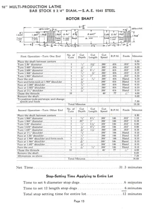

I was surfing Vintage Machinery website, Keith Rucker, and he has tons of machinery manuals. I looked at the American Pacemaker, which is supposed to be a top notch lathe. What astounded me more than anything else, was that in the last several pages of the manual, it gives examples of work that can be performed on the lathe, including specific procedures, speeds, feeds, and times. Have a look. On the Rotor Shaft, it state that it should take a net time of 31 minutes. Man, it would take me the whole day to do that!

This lathe is a very rigid “production lathe” with some added features “normal lathes” don’t have. Notice on the bottom of the reference page: “setting diameter and length stop dogs: 12 min.” Most lathes do not have these features.
Once the machine is set-up, the part can be made in 31 min. Not before. Also, the stock comes pre-cut and with centers already in.
Yes, and some heavy cuts…
I dunno.
On the time sheet, it says "chase threads" for 4 minutes each with 10 passes of 18tpi 11/16" length at 77 rpm. And no time to change bits or take measurements. At 10 passes in 4 minutes, that's a pass every 30 seconds. The lathe alone will take 11/16 x 18 = 12 revolutions to cut each pass. At 77 rpm, thats about 10 seconds just for cutting with no lead-in or waiting for the thread dial or disengaging the half nut, or cranking out the tool, or backing off for another pass or taking any measurements.
I do most of my threading at 70 rpm. For most lathes 18tpi is an even number thread that can only be cut on two locations on the thread dial at opposite extremes (say marks 1 & 3 or 2 & 4). It takes up to 20 seconds to transition to one of those numbers which is an average of 10 seconds depending on how lucky you are. It's impossible to get 0 unless the lathe is stopped or you deliberately crank the carriage back to hit zero which means you have extra empty space to thread at the beginning of each pass.
In other words, in an ideal world, it takes 20 seconds to cut per pass. Leaving only 10 seconds to disengage, retract, rewind, take a measurement, dial in the next pass, and engage the half nut.
Is it possible? Ya, it's possible. So it survived the sniff test. But it requires robotic precision that only CNC can do. Mere mortal human beings can only dream of doing that.

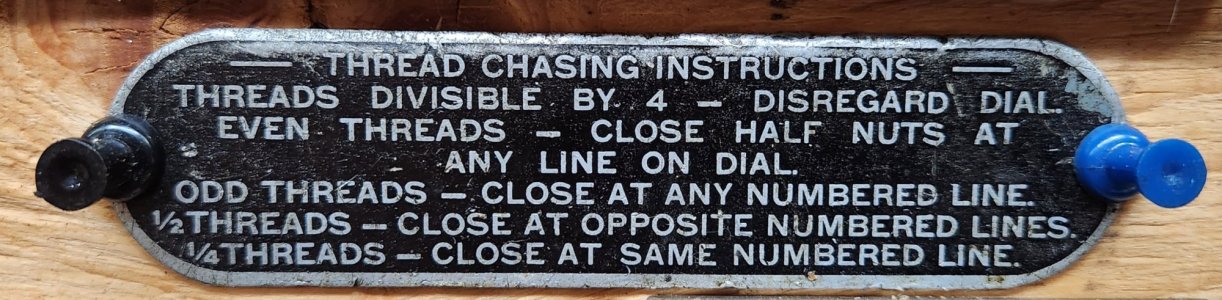

I leave it engaged and reverse. Don't have to worry about dial... (one time only)... Other than that, they do not count human factor...
thestelster
On my lathe, even numbered threads are cut on any line one the dial.
If you leave it engaged and reverse, your 10 seconds are gone cuz you have to reverse at the same speed as forward.
If you crank backward, you can go faster.
Ya, I know that every lathe has different thread dial constraints. I only used mine as an example.
I was really only making the point that normal humans can't do what they claim.
It's marketing BS.
Fundamentally, I'm like you. That job would take me a day. Maybe two.

I think I will give this a test run, or at least just the thread, when I have an opportunity. I'm sure I can do it within the allotted time of 4 minutes. For the other segments, since I don't have multiple stops, I'll wait until I get the DRO.
If you can do that all in under 4 minutes, I'm, going to recommend a new class if membership - "THOSE WHO WALK ON WATER". Don't forget that setup and measurements must be included in the time.....
Your word that you did it will be all that I need to pursue the new membership category.
