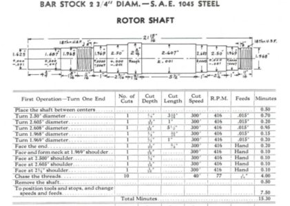

WOW, Speed of Machining

I think Robin has got it, all positions are set and the 31 one minutes is about 99% chip making. Kind of like a football game, a 60 minute game takes 3.5 hours but has only 10 minutes of actual play :)

The problem is that they list a separate time allocation for setup. So that means their time is all-in not just cutting time. I can buy the cutting time. I can't buy all-in. Now mind you, that is looking at it through my eyes which are quite anal about such things - (although my eyes are blue not brown). So ya, we need a "walks on water" membership category. And ya, we could do a "walks on water" competition.
Intial setup is round stock cut to 11/16 length x 1.968 OD.
Change Gears can be set in advance and so can threading tool since this time is included elsewhere in the promotional brochure.
Participants must use a stop watch of some kind, and final thread must be a Class 2B fit measured before stopping the clock.
For arbitrary consistency, the threading operation must begin with tool 1/4" right of the face and 1/8 inch retracted from the bar with no zero set yet for contact at face or bar OD. Lathe must running at lowest rpm, and half nut disengaged.
Threading operation does not include a test cut for thread pitch. This can be done in advance. However, contact with the bar cannot be zeroed or measured. This is to reflect the need for a tool change at this stage of machining.
Elapsed Time must include:
- all measurements,
- cutting a 1/8 thread relief
- cutting threads in 10 passes
- no roughing cuts allowed
- final nose chamfer to thread root
- final thread fit confirmation
As Class 2B
Am I missing anything?

They have a time for cutting the relief cut, "face and form neck at 1.969" shoulder." So the test piece should have that already. I also think that a turning tool should be on the QCTP before the stop watch starts. And the spindle speed should not be higher than the given 77rpm.

So, am I understanding this correctly: we are just trying to duplicate the threads in the first op in 4.0 min and ten passes?
Note: the material is 1045 steel; that stuff machines quite well.

Yes, just the threads, as a test. But the final exam will be the whole thing!!
((To be able to do the whole part in the alloted time, if you don't have multiple cross stops, you'll need a DRO, (and that'd be slower than hard stops)).
The face and form neck is at 1.969 not 1.968. There is a separate face at 1.969. But arguably not at 1.968. So I would argue that it is not included. But if I accept your suggestion that a turning tool be mounted before starting the clock, l'll agree to a 10 second allowance to cut and face the relief.
I further agree with your contension that only lathes with a 77 rpm or lower limit be allowed. And while I am considering alterations to the rules, I believe that VFD Controls for speed should be allowed, but not ELS. This is after all about lathe skills, not automation.
