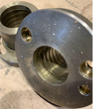

Hello folks.
My King USA mill started to act erratically for some time. I decided to have a look and yesterday removed table and started diagnosing. To my utter disappointment I discovered that nuts (there are two to take up a slack) are worn completely. I am not sure how this is happened - mill was always generously lubricated, anyway - here is a picture
I will have to rebuild it, so several questions -

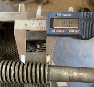

Looks like 5 tpi to me. What markings are on the handwheels for measurements?
This link might help you with common (commercially available) ACME sizes. Maybe its 1.125x5 assuming its an inch graduated machine? Some folks cut their own leadscrews & nuts, some throw some $ at the problem & buy them, all depends on your tooling & abilities & aspirations. Try to find a machine parts/manual, online or otherwise. It will probably state the size there too for confirmation
A more accurate way of measuring unknown threads is encompass as many threads as you can. Then just count the threads encompassed & divide by whatever the measurement reading is. In this machine you probably have a pretty good idea to narrow it down, but I'm talking generally if you aren't sure its maybe even metric. Now if you have significant wear, obviously this isn't going to be 100% accurate but maybe you can traverse outside of that wear range.

1. Is that leadcrew 5 TPI or 6 TPI ? Seems to be right handed? I am a bit confused...
I agree with David. Looks like 5 to me. Peter's method is very exact.
I think your confusion about whether it is 5 or 6 comes from counting teeth vs counting cycles (tooth and valley).
2. OD if this leadscrew is 1.129" - is there closest standard leadscrew. Nearest fractional size is 1 1/4 - does it look right to you, folks ?
I'd guess that 1-1/8 is close enough given that 5tpi was so exact. It seems strange for something to be 4 thou bigger than that, but when I take into account that its an acme thread, it is possible. Not only that, but its the nature of an acme thread to be less sensitive to pitch diameter and overall diameter.
3. Regarding fix - would be OK to bore internal diameter, have some decent wall thickness and then to make a threaded insert? OD of the threaded part is 1 3/4". Make a sliding fit, then to solder insert in pace ?
Not what I'd do, but I see no problem doing it.
Does your mill have a power X drive?
It is easy to forget to unlock the gib locks and then use the power X. The power feed can overpower the gib locks and (hidden by background noises) you may not even notice - BUT this is stressing the leadscrew/nut and greatly increases wear.
Yes it does. I am starting to belive that it is my fault and not going to blame previous owner (as usual 🙂 ) .
Ya, @CWret has a great point.
Another potential cause is our efforts to reduce backlash. I constantly read about others adjusting their backlash to zero or at least as low as they can. I adjust mine to minimum at its tightest locations which is usually the two far extremes of travel. That can leave significant backlash at its loosest location which is usually the middle of its travel. With just normal wear, that can mean 20 or 30 thou of backlash or more. While that might strike mortal fear into the minds of many hobby machinists, it does not bother me. I simply take it into account when I am using the machine.
Just like the power feed, trying to adjust to zero backlash on a slightly worn leadscrew can easily generate forces that can rapidly wear a leadscrew nut.
