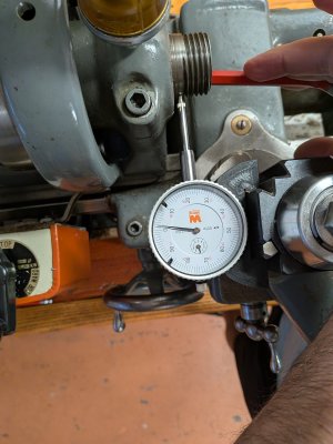

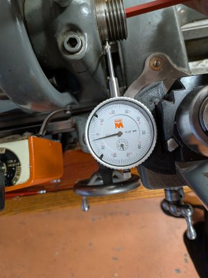

Lateral spindle play using the SB method (ish - I can't mount an indicator at the top of the spindle, so I checked laterally). ~.002" in one direction and ~.004" in the other, which is out of spec (.001-.002 I believe is the target). This is with the headstock bolts barely snugged up, since under any appreciable tension the spindle binds. This is a problem, and I almost wonder if additional shims are needed instead of fewer.

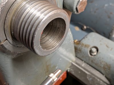

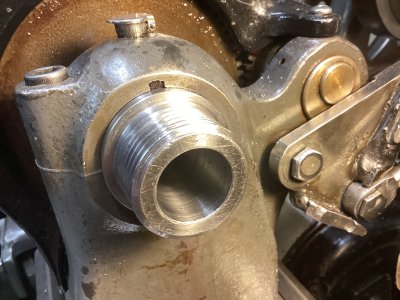

Spindle runout. The outer surface isn't smooth so I don't trust it. The interior is rough and ridged, so I suspect it has been bored out in the past... I'm not sure how to get an accurate read on spindle run out based on this.

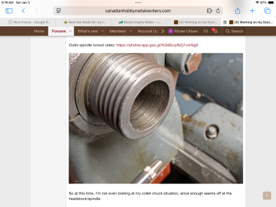

Outer spindle runout video:
https://photos.app.goo.gl/XUkBxJyfb2j1vmGg9

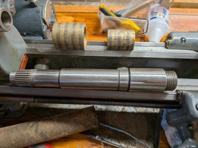

I can of course disassemble the spindle assembly again for a closer look...
