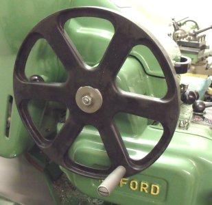

Hi Michael,
You can use a lathe handle to turn the chuck whilst threading. I occasionally use my lathe handle for threading fine 40+ tpi threads. Also useful for internal threading, particularly when you cannot see inside the bore.

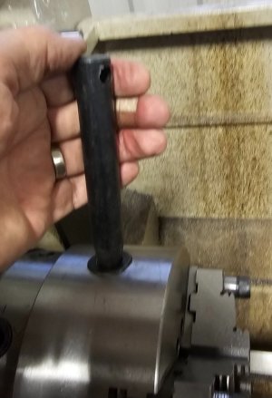

This is my lathe handle made using an old washing machine plastic pulley. I put a handle on the rim to give me better control, but you do have to be careful not to start the spindle whilst its in place.

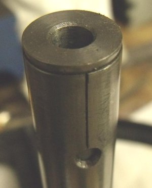

This is a picture of the end of the shaft that secures the handle in the spindle bore. It is a simple expanding collet, expanded by a tapered wedge pulled by a screw. The nut seen on the winding wheel is used to nip the expanding collet into the spindle bore.
Clever addition!
I made one too. I used it at first and then discovered that I get much better control just using a chuck key without the T. The backside crank got converted into a different tool.
You can easily turn the chuck with your face buried right up close and personal to the threading process. You can't easily do that with a backside crank.

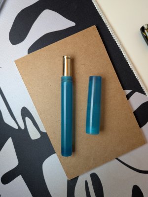

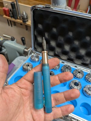

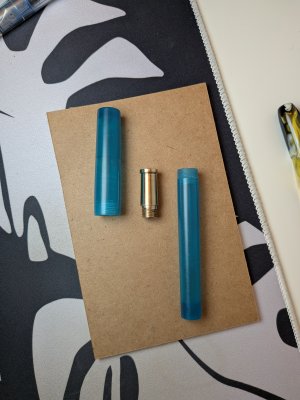

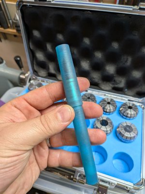

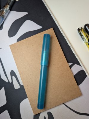

The brass section turned out well for a first try. Needed a slightly different taper but it's fine for a prototype. Cap and body externals also came out nice. Kicking myself for deciding not to do the full internal sand and polish, not sure why I thought it wouldn't need it!

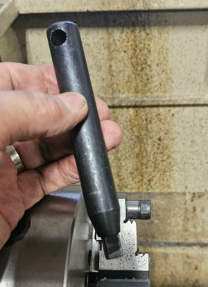

Golem, buy a MT3 ER32 collet chuck & some 3/8-16 all thread & make a draw bar for it.
Both parts’ll be fairly cheap and i think it’ll be pretty close.
Thats assuming your MT3 taper in your spindle is true.
If my collet chuck was the issue, sure. And it may be part of it, but I think I've got a bigger spindle/headstock problem and I'm not sure how that would help there?
I also suspect the spindle has actually been modified, it does not look like an MT3 internal.
South Bend lathes don't want MT tapers if I recall correctly
