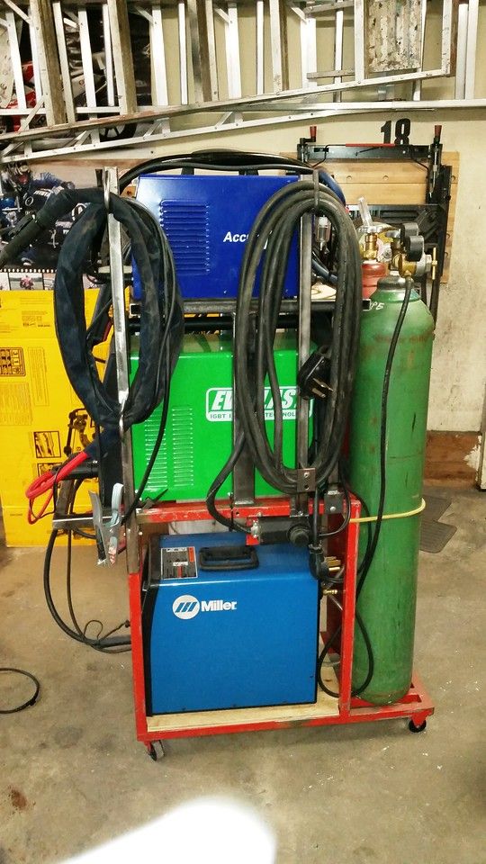

Can anyone tell me if a Miller Maxstar 150 STL is worth fixing?
I don’t know what’s wrong with it. All I want is a 110v stick welder and I’m sure I could get this Miller cheap
i have seen those little guys dropped from scaffold, used in sauna like environments, rain, you name it, they are tough little units, ive never seen one broken.....that being said, the whole board is encapsulated in some kind of expoxy from what i recall, and thats really all that is inside the case, so unless its just a loose connection to the board repair is going to be the whole board...$$ so if your going to get it, get it cheap, like 100$ kinda cheap
i have had one of those little guys for almost 17 years, 6010 is a no go, it will burn 6011 decently, 7018 burns ok, getting it started is a little tricky and takes some practice compared to a larger machine, and can be frustrating to less experience stick welders, but it can lay a nice bead, and will run 1/8 7018 all day on 220, it has just enough duty cycle for it to never be a problem
as for running it on 110 with stick......3/32 7018 is the limit, short beads, take breaks, it will blow a 15 and even a 20a breaker in short order, if you are going to do any decent amount of welding on 110v you would probably be stuck with 3/32 6011 (as you will be probabaly down in the 50a range)
now tig on 110v, no problem, you can run it full out at 150a and it wont blow the breaker, they are great for that
The positive lead is loose (won’t tighten up). I’m guessing that’s an easy fix? I’ll mess with it later

the one of the leads doesnt tighten, it will just spin, i do believe its the positive (wich ever one doesnt have the o-ring inside the connection), i dont know if thats the design of a 10mm dinse connection, or if its just the ones that miller decided to use
when you plug it in and turn it on does that little blue light even come on? if it doesnt thats where i would start, work your way back from the wall plug to the power connections inside the machine

If I plug it in and turn it on the blue light comes on, and I can move the green light for the 3 different processes. If I had a lead and a ground I’d try it out. All that’s with it is the tig torch and cable

those dinse connectors are really expensive at the welding stores, sounds like you need to put some cables together, those connectors are cheapest on amazon, if you dont get an arc i would start looking at the connection form the dinse connector to the board....like i said those little machines are really tough

@Chicken lights Did you ever get this welder working? One came across my bench last year but the owner took it back to the dealer. He had had it for years though and I don't think anything happened after that. I forget what the blue light means now but at the time, it sounded like an issue with the PC Board that required replacement, although I did not pursue it as he thought the dealer might look after him. iirc, the blue light issue was common.
Just curious if I should try to get it back on the bench to troubleshoot some more. I suspect all surface mount technology though so probably a board replacement only repair.
