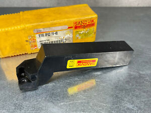

Of course, if your toolpost doesn't have enough elevation adjustment to mount the tool upside down, then you could always get one of these:
Specifically designed so that you can go upside down.

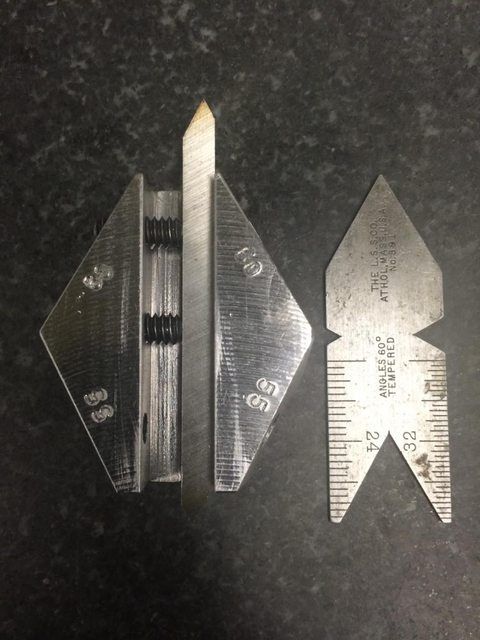

I'm pretty boring, and use std HSS mostly. I have a variety of toolbits I've ground over the years, big and small, and generally have one that will fit the need at hand. I do use std 16er carbide inserts in the CNC lathe at work, and will occasionally rob that tool for use in the manuals when I can't hold something in the CNC.
There are a lot of nice tooling examples in this thread I would like to own or make someday. The reality is though, I just don't do much single point threading.
I think I've got some internal/external import insert tooling at home, but I'm not sure. I went on a import tooling buying spree a few years ago for the lathe, but can't remember off hand what I have. I rarely single point thread at home. I prefer to do it all at work when I need to. When the options are a Hardinge HLV-H and a Nakamura CNC lathe vs a Myford Super 7, the Myford loses everytime lol. I should do one this weekend just to see if I still remember how.

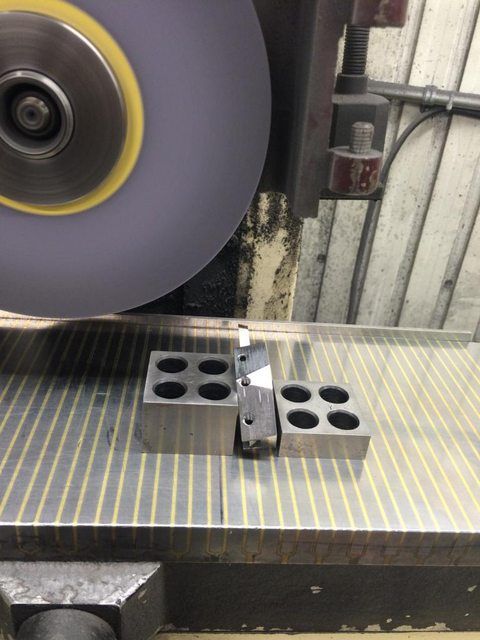

I made this grinding/sharpening block quite a few years ago for the surface grinder. It does the job, but If I were to make it again, I'd make it bigger. This little one requires too much blocking to hold it in place.
One of those "seemed like a good idea at the time" projects from the days when I had time, and really enjoyed making stuff lol. I've probably used it less than 5 times.
