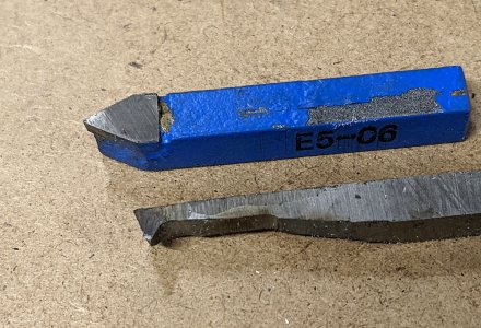

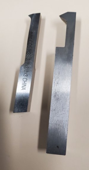

These are the only two internal hand ground tool bits I could find. I made the big one from a 5/8 tool bar for really big threads under 10tpi. For smaller threads over 10tpi I used to use the small ones ground from 3/8 tool bar. I know I also made one out of 1/4 tool bar, but I couldn't find it. It may have been repurposed. No matter, I usually use the Mesa or Warner tools instead anyway.
The small one has seen lots of use over the years. I've prolly ground a dozen of them or so just like it. Just no idea where the rest are all hiding. Doesn't matter, these two should address your needs. For teeny tiny internal threads I use a tap just like everyone else. Someday I might try single pointing a #10 screw hole, but that will have to wait until I'm older and wiser....... ;)

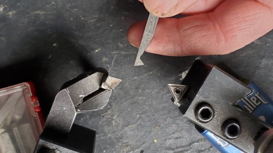

Here a shot of some of the threading tools I use.
The small insert tool is a Warner hss insert and like it.
The little tiny 3/16" square hss bit was for a small internal thread I didn't have a tap for.
And the odd looking one is a 1/4" square hss ground for the eccentric diamond tool holder. I'm not sure it has any big advantages over other styles other than it expands the capability of the diamond tool holder and if you already own one it may save you from buying other tooling.

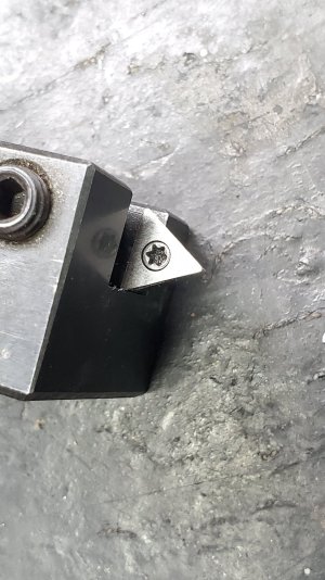

The second photo shows the Mesa tool threading/grooving insert tool and then a little carbide threading tool (which I haven't yet tried) I bought from Aliexpress. With my little lathe I probably should stick to hss threading tools but the carbide inserts are convenient.

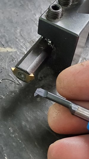

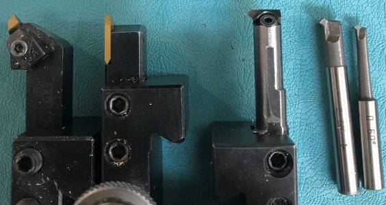

Here's my collection of threading tools. I use insert tooling except for tiny internal threads, then I go to the round HSS tools shown on the right.
L to R - Kenametal Top Notch, Nikole Thin-bit, Manchester boring bar, Round tooling - unknown maker
I think the round tooling came from a friend who had a Swiss machine for making dental implants. The beauty of the round tools is that you can regrind the top face as long as your regrind is on axis to the centre line.

Whoops! That ain't a hss insert in that tool holder. But this one is. Sorry.

I tried to grind an internal threading tool once, it wasn't - and still isn't - pretty. I had a lot of problems getting the clearance right on the bottom of the tool and not dragging in the hole. It was very springy also, so I had to make pretty light passes.
I think it would help to hold a small tube or bar the same size as the drilled or bored hole that is being threaded, up against the end of the threading tool. You can immediately see where relief is needed and where it is not. It's good to keep as much meat as possible to maximize the tool rigidity without rubbing in the hole.
