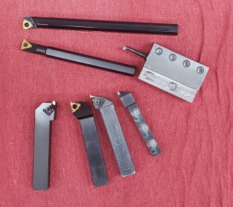

What are you guys using for lathe threading tools?

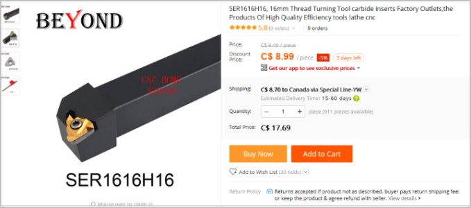

Got a link to the AliExpress Mesa tool? I like the looks of that. The one's @Susquatch linked to look interesting but just a little too pricey.
I think perhaps your thrifty tongue is in your cheek...... Ya, they are definitely not Ali priced. And as @DPittman suggests, I doubt they are available there. Maybe at a few specialty sellers. I think I recall that Brownells & Midway both sell them. Maybe Grizzly too. They are very popular with precision smith's.

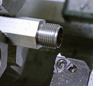

I don't see what you mean Peter. I see the inverted tool, but what is all that stuff on the LHS of your drawing?
I didn't explain it properly. Round-2. If you use a conventional RH threading tool tool in conventional direction TS to HS mode, you can thread up to shoulder like so. But if you take that same threading tool with intention to invert it to thread away, HS to TS, then the shank must rise relative to the tool post in order to be on centerline of work. A smaller lathe/toolpost may not accommodate that a/p side view. What you ideally want is a LH threading holder...which is a different toolholder & different insert, at least on Carmex style topside insert style shown. Not all toolholders hold the cutting insert the same of course. I'm just saying check it out beforehand. I see Mesa makes a double ended one with upright tool. Not sure about the HSS version didn't get that far.

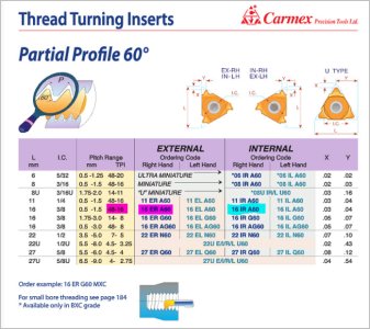

Was just looking at the warner threading tools and they show inserts with 10 deg. back rake and 0 deg back rake. What would the application be for each?
The thing with the Warner tools that is VERY unusual is that they are SHARP HSS Inserts. If I remember correctly one of them is for inside threading and the other is for outside threading.
These are awesome tools.

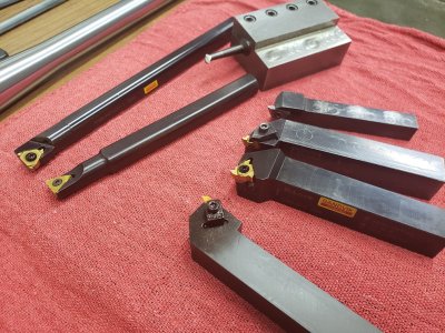

I'm pretty boring, and use std HSS mostly. I have a variety of toolbits I've ground over the years, big and small, and generally have one that will fit the need at hand. I do use std 16er carbide inserts in the CNC lathe at work, and will occasionally rob that tool for use in the manuals when I can't hold something in the CNC.
There are a lot of nice tooling examples in this thread I would like to own or make someday. The reality is though, I just don't do much single point threading.
I think I've got some internal/external import insert tooling at home, but I'm not sure. I went on a import tooling buying spree a few years ago for the lathe, but can't remember off hand what I have. I rarely single point thread at home. I prefer to do it all at work when I need to. When the options are a Hardinge HLV-H and a Nakamura CNC lathe vs a Myford Super 7, the Myford loses everytime lol. I should do one this weekend just to see if I still remember how.
