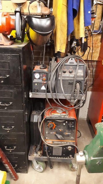

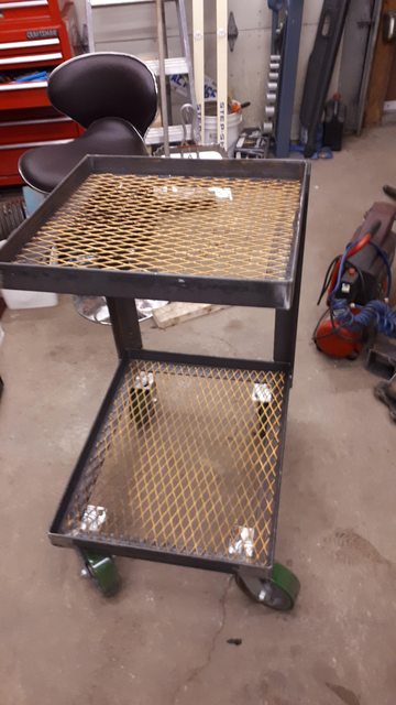

Here’s what I built for my Primeweld and Millermatic MIG.
Still need to add a drawer under the TIG to hold consumables and make some rod holders.
The frame was made from a warehouse cart that I bought for $50 and cut into pieces.
Thanks @David_R8 Nice job! Did you put the larger welder on top for easier access to the controls? My OCD would have me putting it on the bottom, for that balance, pyramid/stable look but your build makes a whole lot more sense from a user perspective. I think that will be my situation too as the Mig 180 does not have much on the front either. But I need to remember to access the side door for roll changes.
You got it, it's on the top for ease of access to the controls. It's pretty much at eye level when I'm sitting at my welding table.
I need to figure out how to get my plasma cutter on the cart now. The MIG faces forward because the cables stick out so much,
The best feature are the custom made, tank belts. They were made by a member who is local to me. He is a kick-butt fabricator with a to-die-for shop.

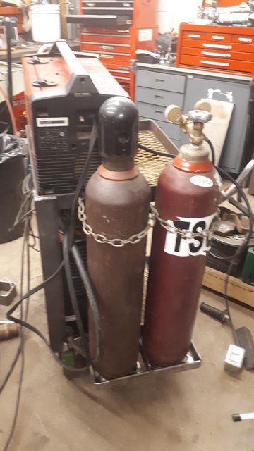

My two cents...I've built a few welding carts in my day although my last couple of machines came with running gear. Some lessons I learned from copying big blue and big red:
1) Consider lowering your tank shelf. I know it is extra design and fab work, but it is worth it. As you get older picking up those tanks is dangerous and no fun for your back. The lower shelf makes it much easier (see pic). Even with the lower shelves on my MIG and TIG, I still had to downsize my tanks to "K's" as I got older so I could handle them without an assistant. It's no biggie when you are in your 20's or even 30's, but those T tanks hurt at 50 years old. The lower shelf means you can just tip them on and off easily because they are only an inch off the ground. The lip on the shelf serves two purposes; it strengthens the sheet metal and catches stuff that falls (like nuts, bolts, screws, etc.), from falling off and getting into the wheels (see #2 below).
2) Consider much larger rear wheels. In a shop environment larger rear wheels means the inevitable rocks, nuts, bolts, etc., that fall on the floor and get trapped under the wheels are easier to navigate. Front wheels with swivels can just be maneuvered around small obstacles, but fixed back ones can get hung up. You don't want to be tugging on anything that big or top heavy if this happens.
3) Hangers for cords, etc., are great, but be careful not to add them in such a way that the cart is too wide or ungainly to fit where you intend to put it. A great option is to install nutserts/rivnuts or PlusNuts in various locations in the tubing or angle iron you build it from. This way you can paint/powder coat the cart and it looks nice, and later bolt on hangers for stingers, ground cables, etc., if needed without having to sand off your paint, weld on a hanger, and re-paint.
4) Do paint it. Unlike a welding table where you want electrical conductivity, there is always a risk of shorting things out on a welding cart. Especially if you build it to also hold a plasma cutter at some point (which many people do), your don't want a clear path to ground through a compressed gas tank. Paint offers some protection.
