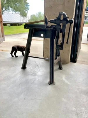

Do you put a block of concrete under the leg of that vise? Is that to avoid having a large massive workbench to deal with pounding on something in the vise?
Agree with John, there should be a large block of something relatively solid, at the base of the post vise, to absorb the energy of the strikes it was designed to take!
The leg is to direct the force from pounding directly down into the floor. They usually sit in a block of steel, wood, part of the leg of the bench, or in the floor directly. I'm going to make something similar to this, so it will bear onto the stand itself.

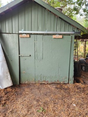

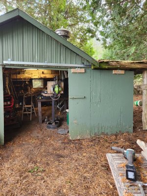

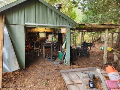

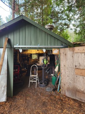

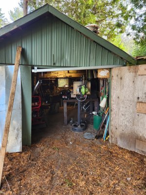

Today didn't start as early as yesterday, but I reached my goal. Chimney done*, forge operational before dinner.
Started off just cleaning and removing junk. 2 garbage bags full, and a trailer load of wood for the burn pile.
Then I played around with the forge in different positions, but settled on my original one from yesterday lol.
I removed the section of shelf that ran behind, and marked the opening in the roof, then jigsawed it out.
Hoisted the chimney in place and just set it down on top of the hood to get an idea of how I'm going to mount it.
View attachment 39243View attachment 39251
It's really tough to work with a building that is SOOOOO out of level. That stack is perfectly plumb right there......It's out about 4" over 24" sloped to the back. The NE corner is also sitting on top of the roots from the big white pine and even worse. Remember when I said this wasn't my first choice of locations....but oh well, I can compensate......
It came with a lower support that would sit between joists, but I didn't feel like building framework to hold it like that, so I went back in the shop, and had a quick peek of what was laying around and came up with this.
The ratchet strap is temporary until I can make a steel one. But it's pretty sturdy mounted this way. Debating if I need more support. Once I get the flashing buttoned up it should be pretty constrained, but I can always add some more strapping from the inside, or a brace to the ridge outside.
I tossed the roof flashing collar on it, and the cap, but that's all I'm doing today on it outside.
I had full intentions of finishing the flashing and making it water tight today, but 2 things stopped me. That roof wont hold me.... and b, I need some caulking. Next weekend I'm going to remove that lean-to on the rh side, so I can more easily access this from a ladder. That roof tin is so full of rust pinholes I'd go right through it. Who'da thunk it that 4" of decomposing leaves and pine needles for a few decades would compromise the structural integrity of roofing sheet metal lol. Anyway, that flashing is just sitting up there looking pretty until next weekend. If it rains it'll leak, oh well.
The pipe to join the hood to the chimney is just 2 sections of 7" duct that I joined together at the seam, then overlapped and screwed together for a slip fit up the chimney. I imagine there will be some ground movement in here during the winter/spring, so I didn't want a rigid joint. Not code I know, but If anyone see any glaring issues with it, I'm all ears, and would love to hear it.
Looks wonky because it is. Eeverything is so out of level, but that's a problem for another day.....It was now time to build a fire and test it out.
Success. It draws pretty good, for being as short as it is. I think I read that it should be 2' higher than any obstruction within 10'
I'd need at least another 18" section to meet that, as it only sticks up about 4-6" from the ridge, and no doubt would draw a lot better with more stack height, but as is, it works pretty good. I didn't load it up with green coal, but from a cold fire it started drawing smoke right away, and got better as the fire built. I think it will be fine. It draws better than my basement woodstove..... lol. It was also really gusty outside today, so there were a few times the wind would whip in and blow the smoke around, but then it would start going right back up the hood again.
I still have to drag my anvil in here, torches, and a few other tools I don't want in the garage. Will be nice to start making some hammer and tong racks instead of them just hanging around in piles, and drawers in the garage. I also need to redo the doors, and get them on the track that's hanging around in the pics there. With the snow we get here there's no way I'll be able to swing that door open and get in there in the winter.
*I put the asterisk at the start because although it's "done" for now, it's not done 100%. Still have to do the flashing, install the storm collar, and secure the stack a bit better, maybe an external brace to the ridge beam? but it's 90% and "functions", and I'm pretty satisfied with getting it this far.

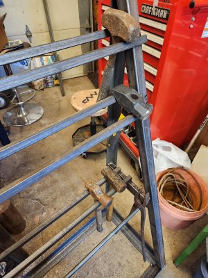

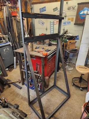

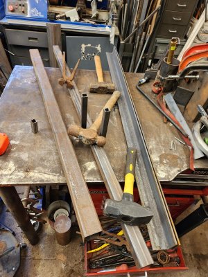

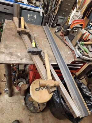

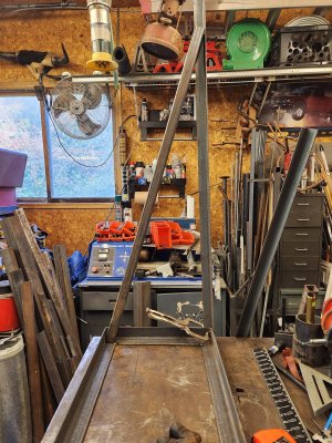

Todays project was to build a hammer and tong rack. Didn't want something too big, but didn't want to to run out of space either. Design and dimensions were driven primarily from the stock I had on hand.
I started by laying out some material, and some hammers to get an idea where I was going.
Satisfied I had a design that was workable, and enough material to build it I started cutting and welding. The base frame took shape pretty quick, but progress was interrupted when My Dad stopped in for a quick visit.
Once he left, I got back to it, and finished it out relatively quickly. I used the side rails from a treadmill carcass for the shelfs. Wife poked her head out when I was cutting it up, and I proudly told her I was finally using the last of that treadmill. She barked back, well I guess you better get another one again then. Not sure if sarcasm, or not, but she's probably right......
There was enough material in the rails to make 3 shelves, but I had to splice the offcuts together to finish the 3rd shelf.
Then I cut some 3/4" square for the hammer racks, and played around with their placement until I was happy and welded it all up solid.

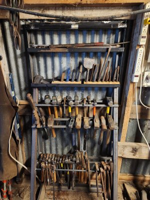

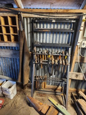

Once done, I dragged it out to the shed, and started filling it.

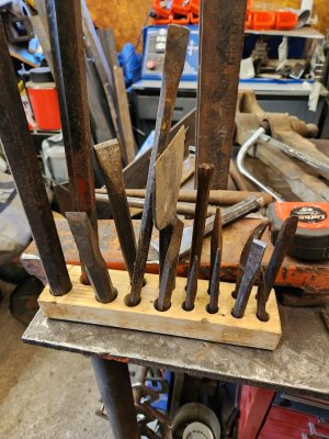

Fits the space great, and should give me some room for my most frequently used tools with some room to grow into. I'm going to cut some wood blocks for the shelves, and drill holes for punch storage. There are some things I want to add to it, but I want to use it for a while so I get a better idea of what I want and where I want it. I'm also going to add some tong storage on the forge itself, so I only have the one rod for tongs on this.
I don't have very many tongs yet anyway. Still adding to the collection. First couple projects are going to be all tooling. Punches, drifts, and some tongs. Both from scratch, and some "quick" tongs I bought on amazon that need finishing. With stuff all setup ready to use now, I can squeeze a quick forging session into some weeknights after work now. Hopefully.....

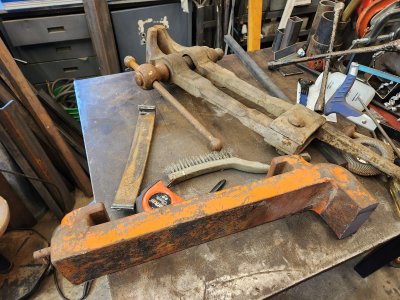

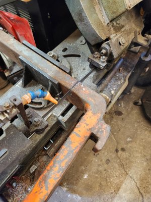

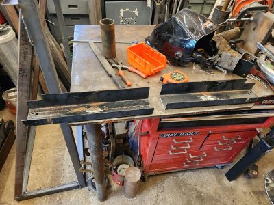

Also repaired a set of broken tongs, and started into my post vise striking anvil stand. Rough cut a new spring, and the fork tine for the anvil face.
Still rolling around design ideas in my head but I have 3 feet of remaining tine to cut up into 12" mini swage blocks too. I'd like to incorporate those into the vise stand too somehow. I'm low on space in there, and want things to have multiple uses. Thinking I'll make a frame that can sit on the anvil face and hold the swage blocks flat on top of it for backing, and a nest for using them on their side beside it. Storing them all below on the stand itself. If I get them cut up this week, I'll machine various shapes and pockets into them.
