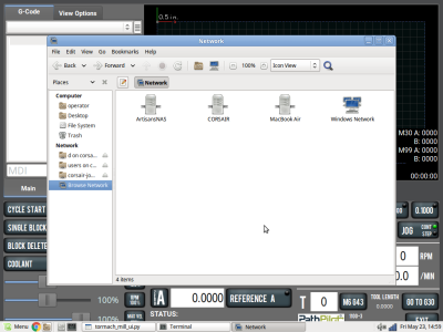

BTW. After much painful work and upgrading etc. I finally have the ability to look at the network via WiFi.

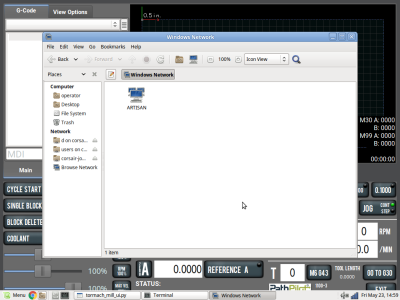

Inside the Windows Network is this which is my workgroup name:

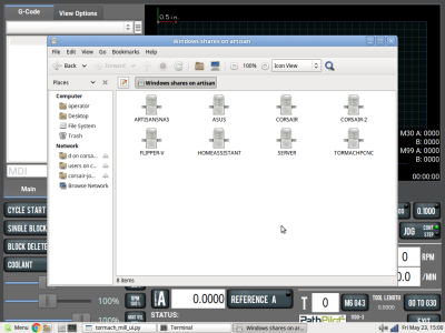

And inside that is my Windows network of PCs etc.

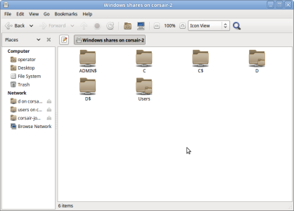

And I can get at the drives of a specific machine.
These screen shots were taken on the Path Pilot machine and using the insert multiple... button on this posting captured from the \\TORMACHPCNC\home\operator folder.
