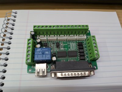

Hmm I suppose I could use the 5-axis breakout board that came with my PrintNC kit.
That's the one. PWM to 0-10V on pin 1 for VFDs with a jumper. Or use Pin 17 of the DB-25 for spindle stepping and Pin 16 for spindle direction.
I have max-x-y+min-z limit switches set on pin 15,
min+home-x, min+home-y ,max+home-z on pins 11,12 and 13 so I can do simultaneous homing.
# P1.12_J12.5 15 IOPort QCount 0 Quad-B (In) min home-y (input)
# P1.13_J12.7 16 IOPort QCount 0 Quad-IDX (in) max-home-z (input)
ESTOP in on Pin 10 and system enable out on Pin 1.
