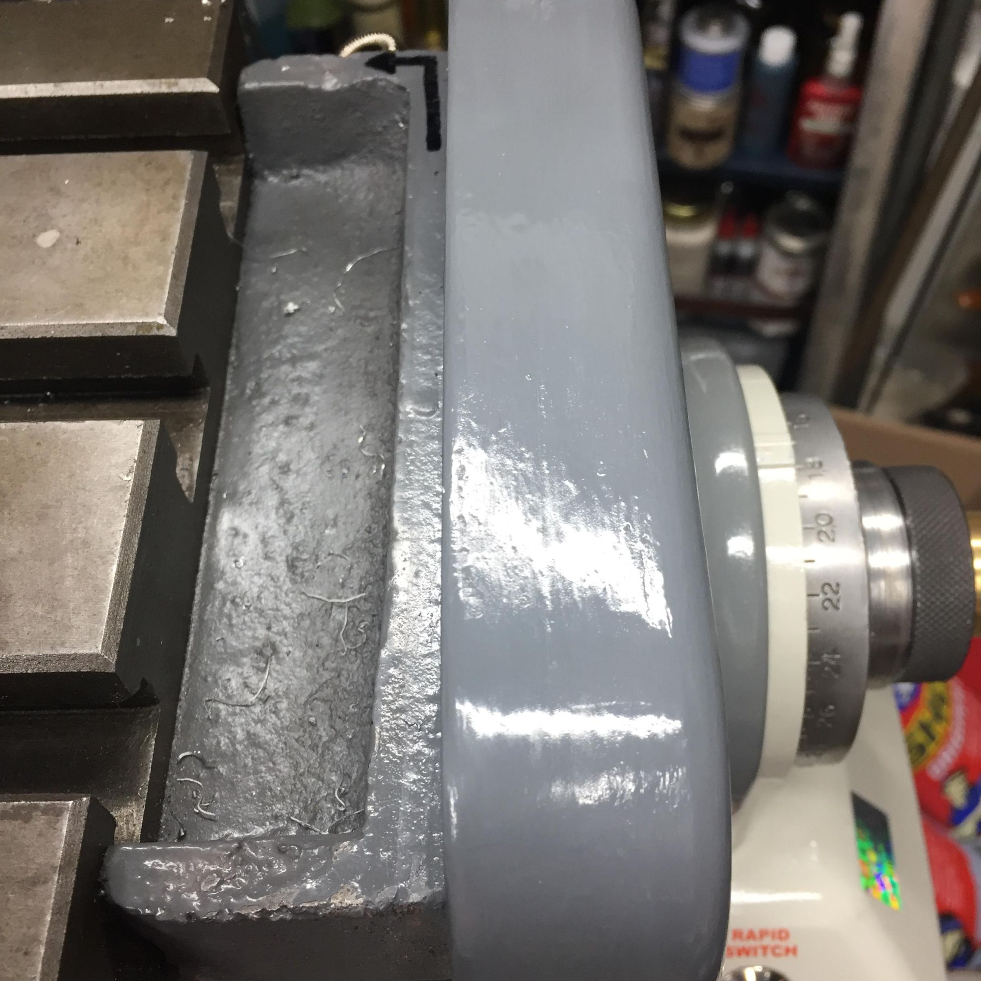

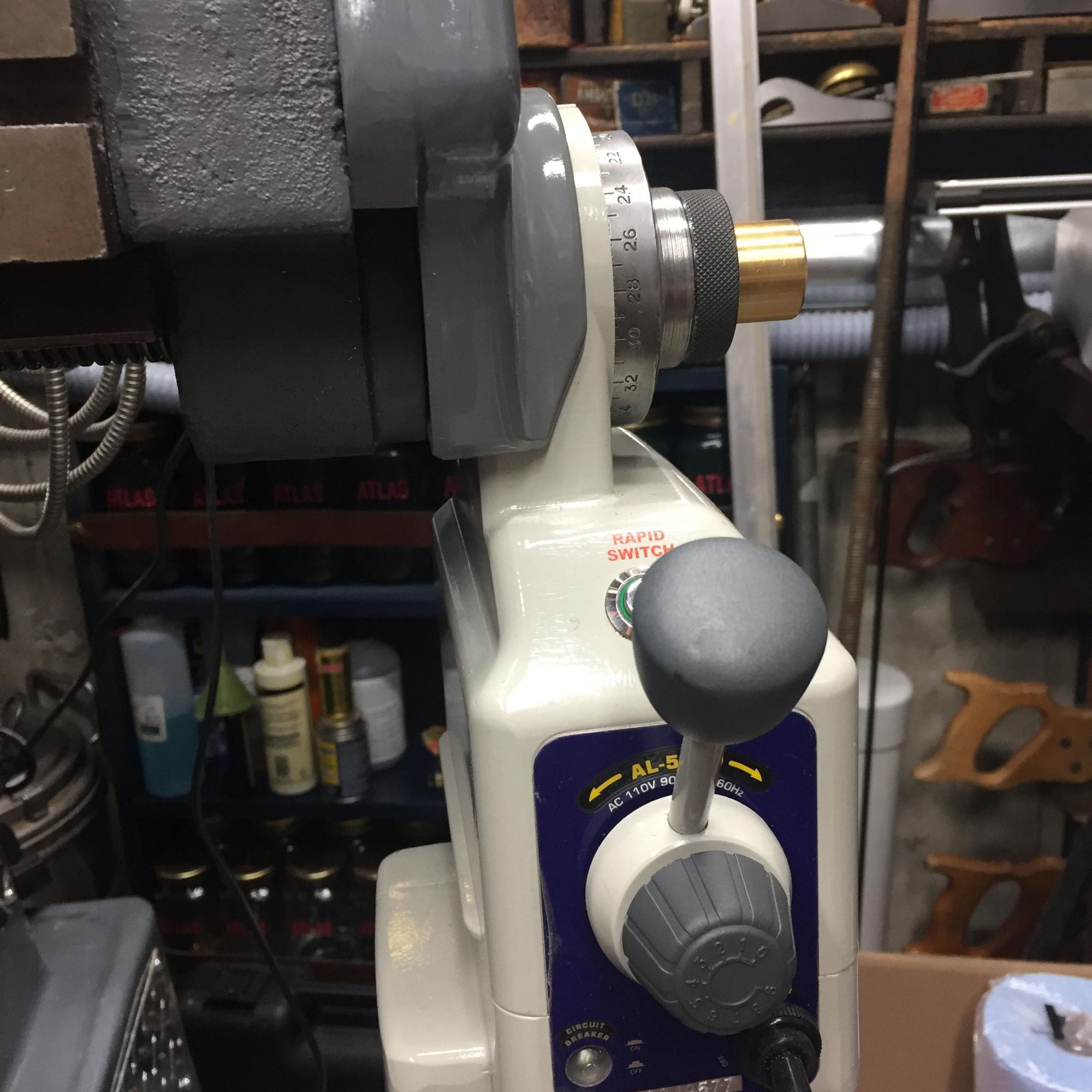

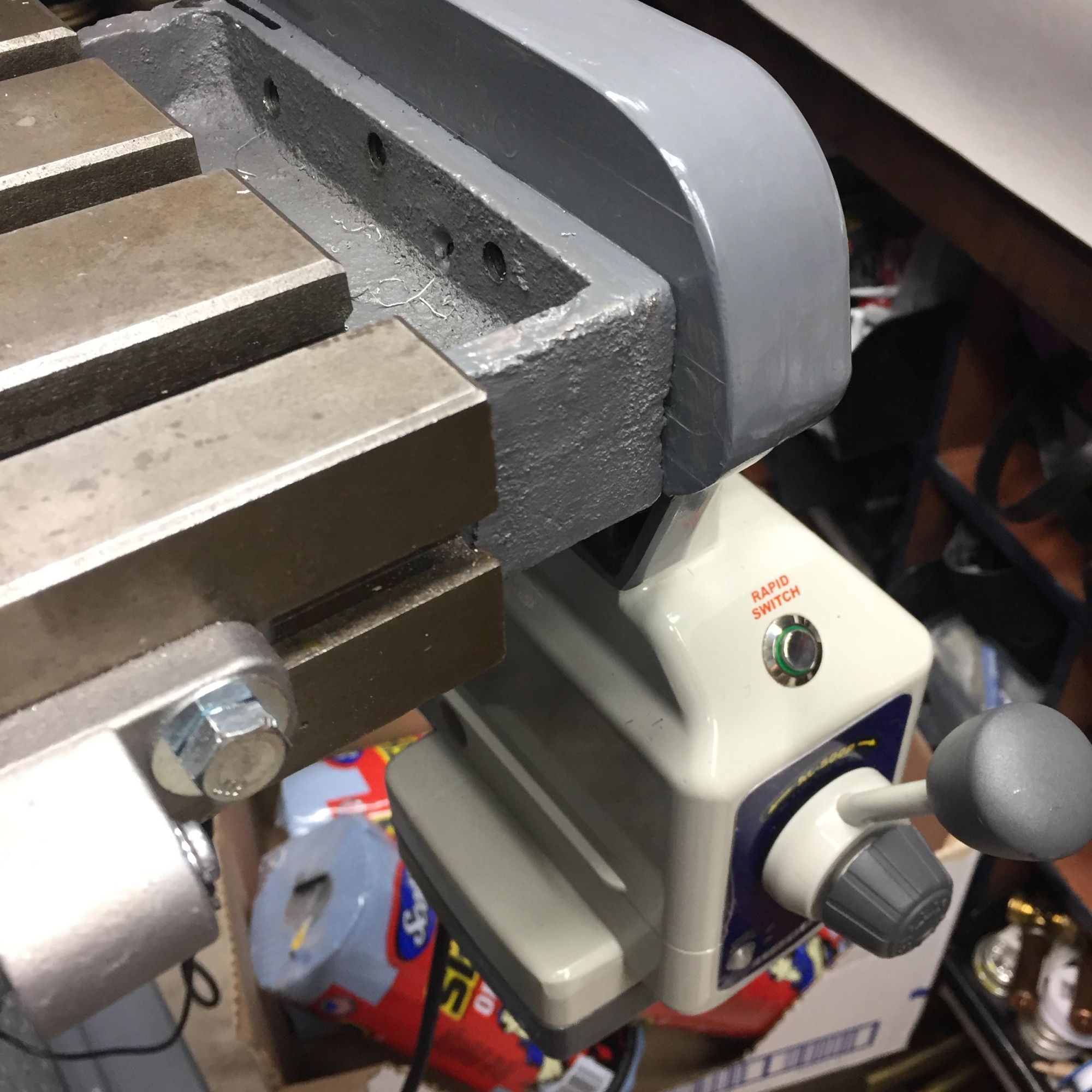

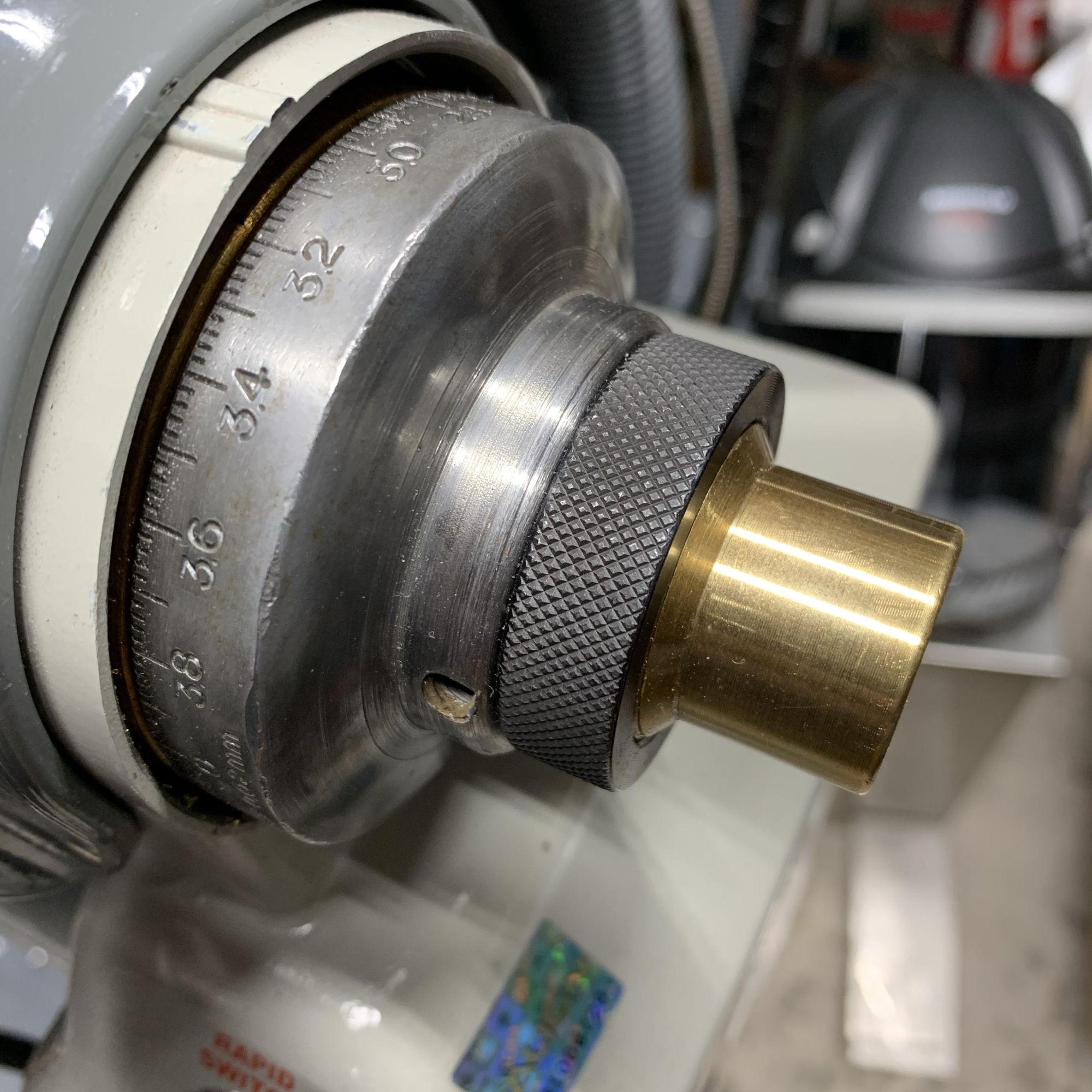

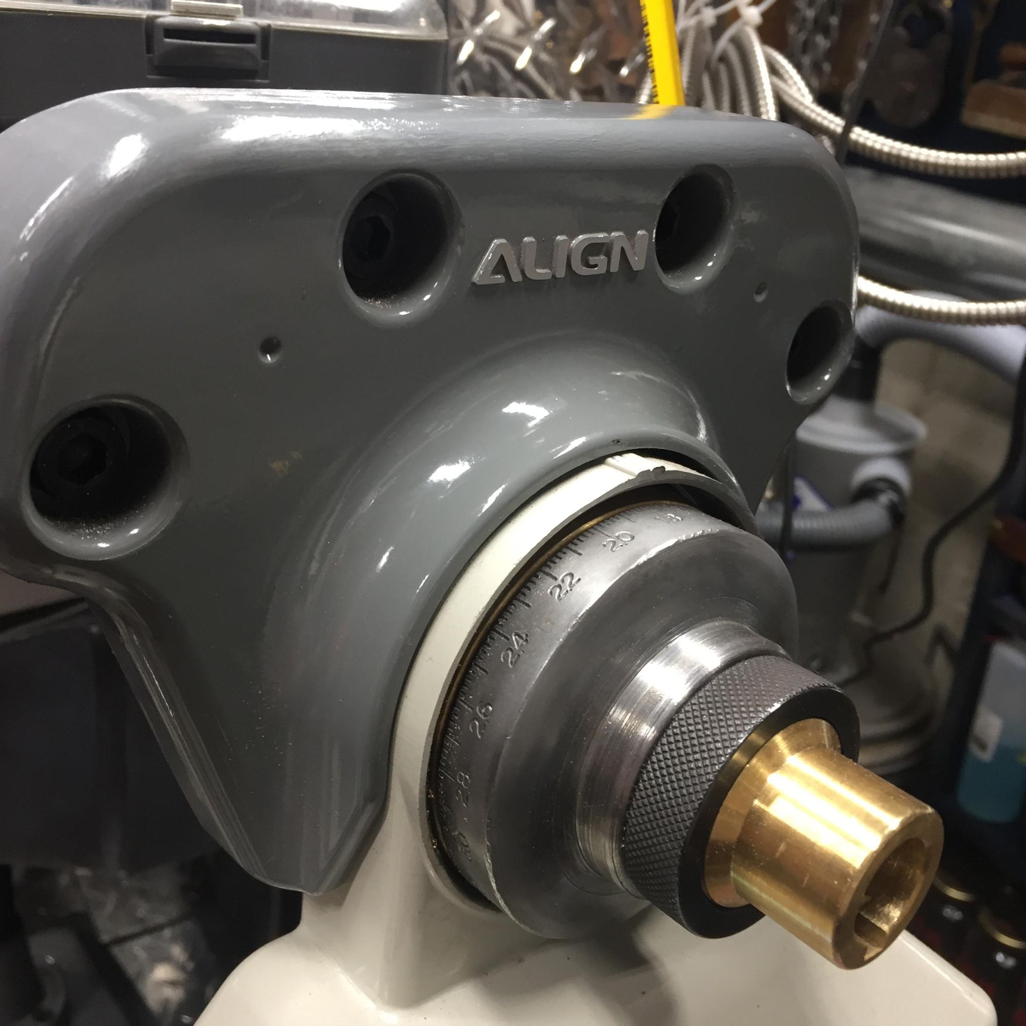

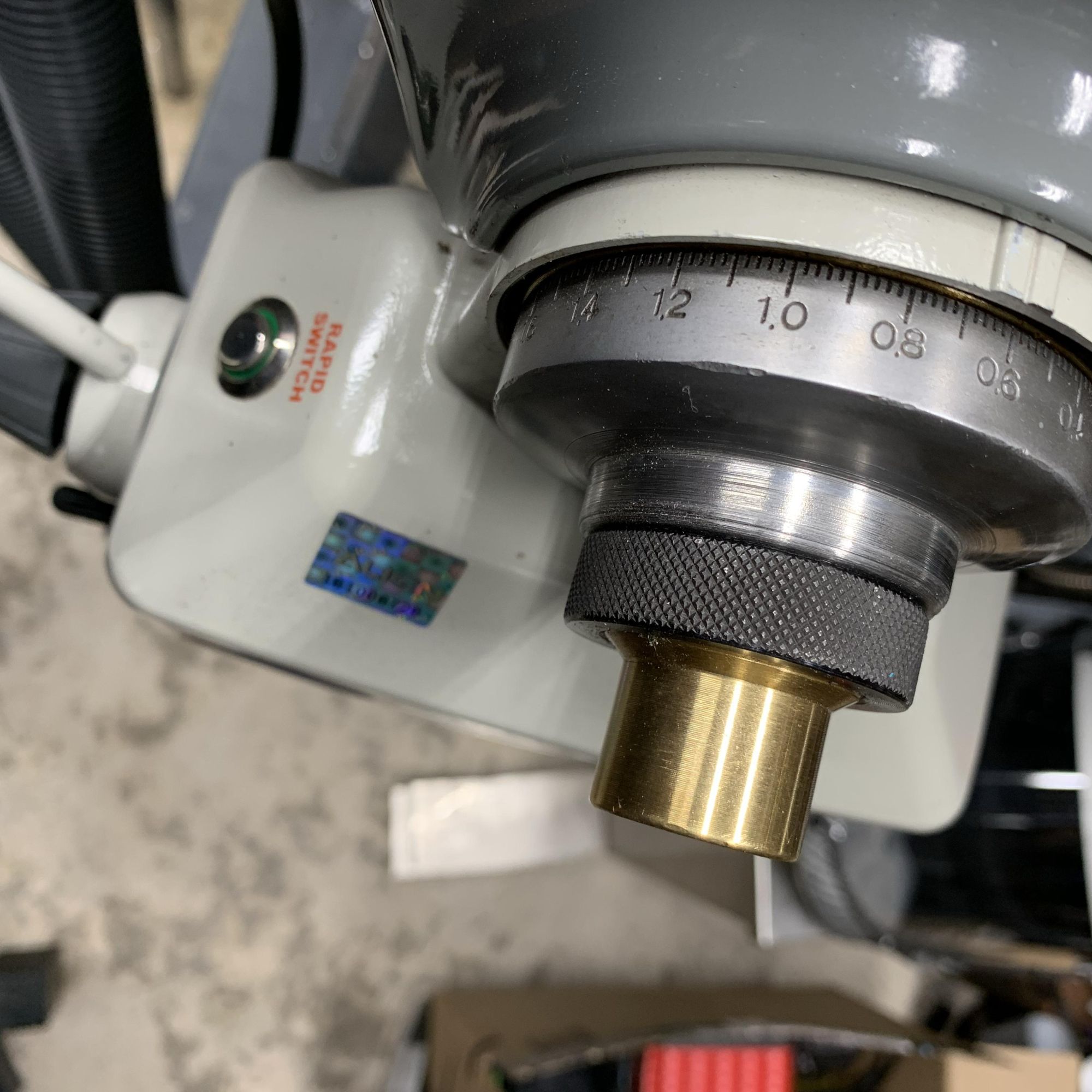

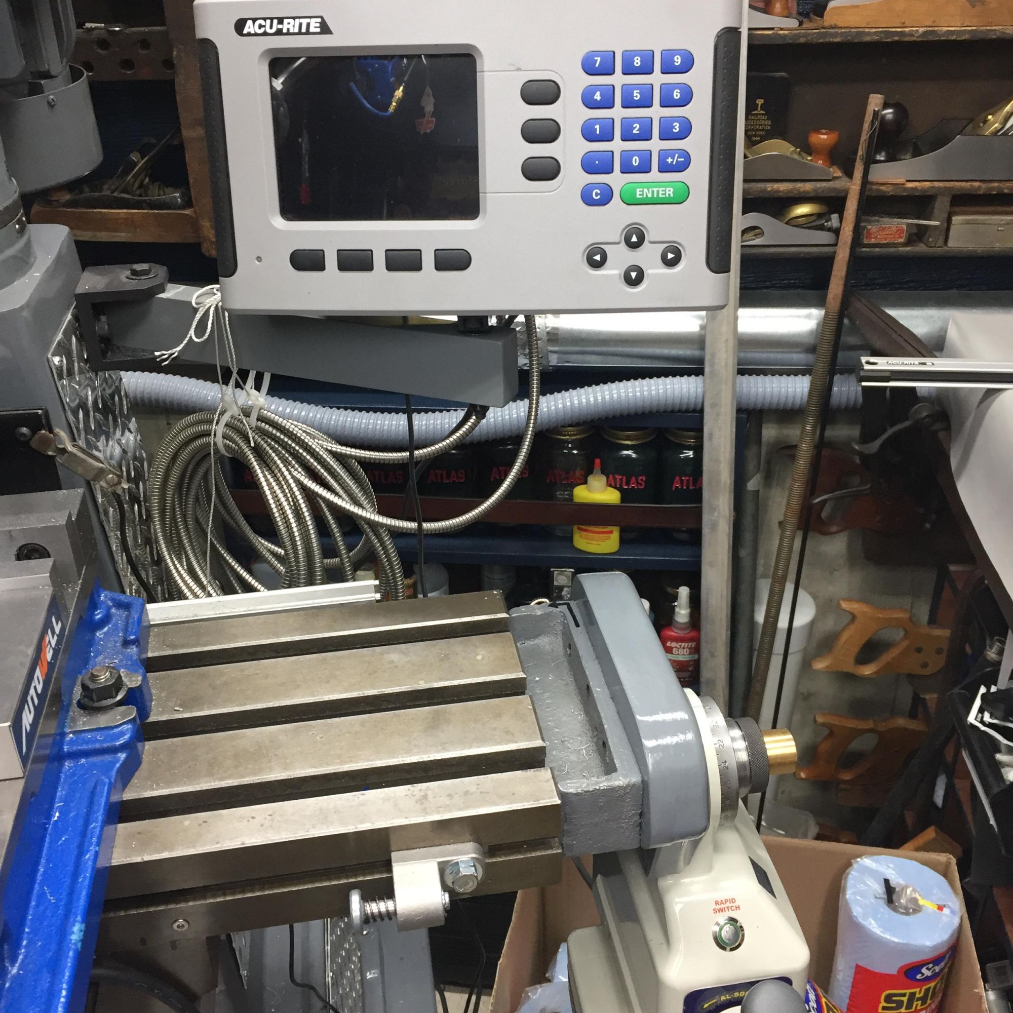

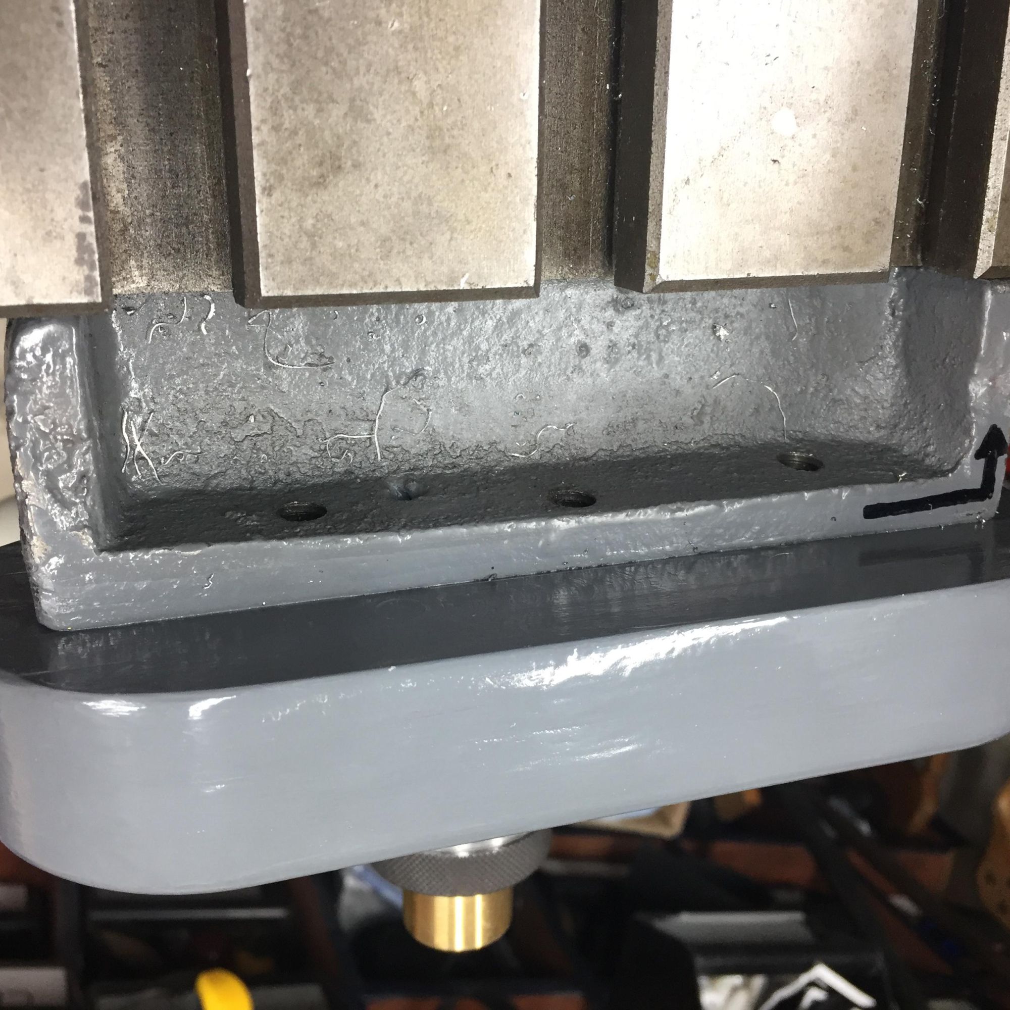

[QUOTE = "TOBARApprentice, post: 24944, membre: 798"] Voici quelques photos montrant comment j'ai surmonté le problème de 4 boulons à 2 boulons. J'ai utilisé une plaque entretoise / adaptateur que j'ai usinée. J'ai tourné une douille pour m'assurer qu'elle était centrée sur la vis mère de l'axe X. C'était un mod relativement simple et a rendu le moulin tellement amusant à utiliser.

Nice job

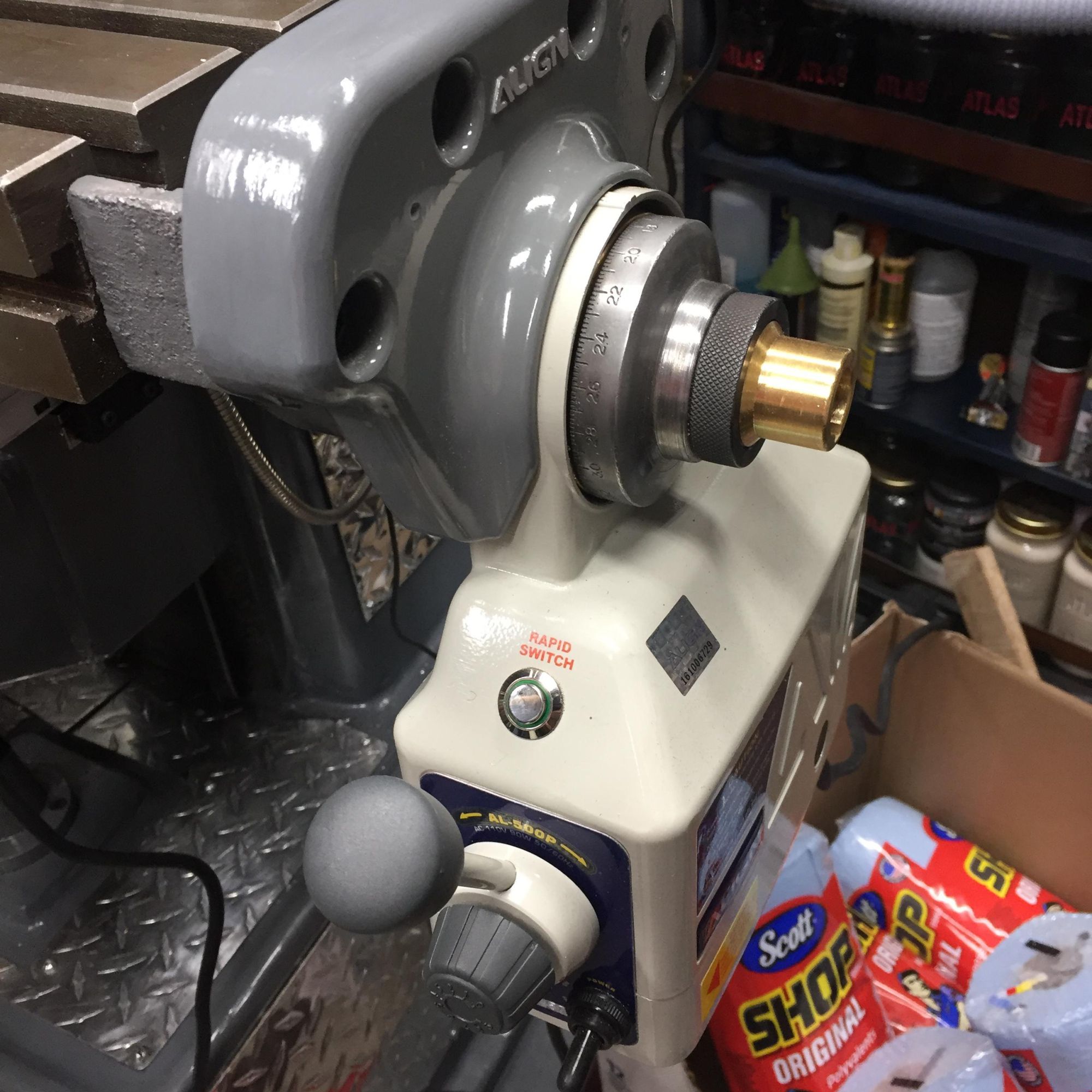

I'm curious what model of milling machine that is... is that fancy aluminum diamond plate a factory finish or is that your own touch?
The Aluminum checkerplate was my addition. When I rebuilt the machine I tool it down to bare metal. Fun fact, that metal was covered by a lot of body fill which made the castings smooth. Another fun fact, I’m not a body man, and I hate doing body work so I decided to clad the machine with aluminum checkerplate. It’s a bit “tacky” but looks good and is in keeping with the industrial theme, lol.

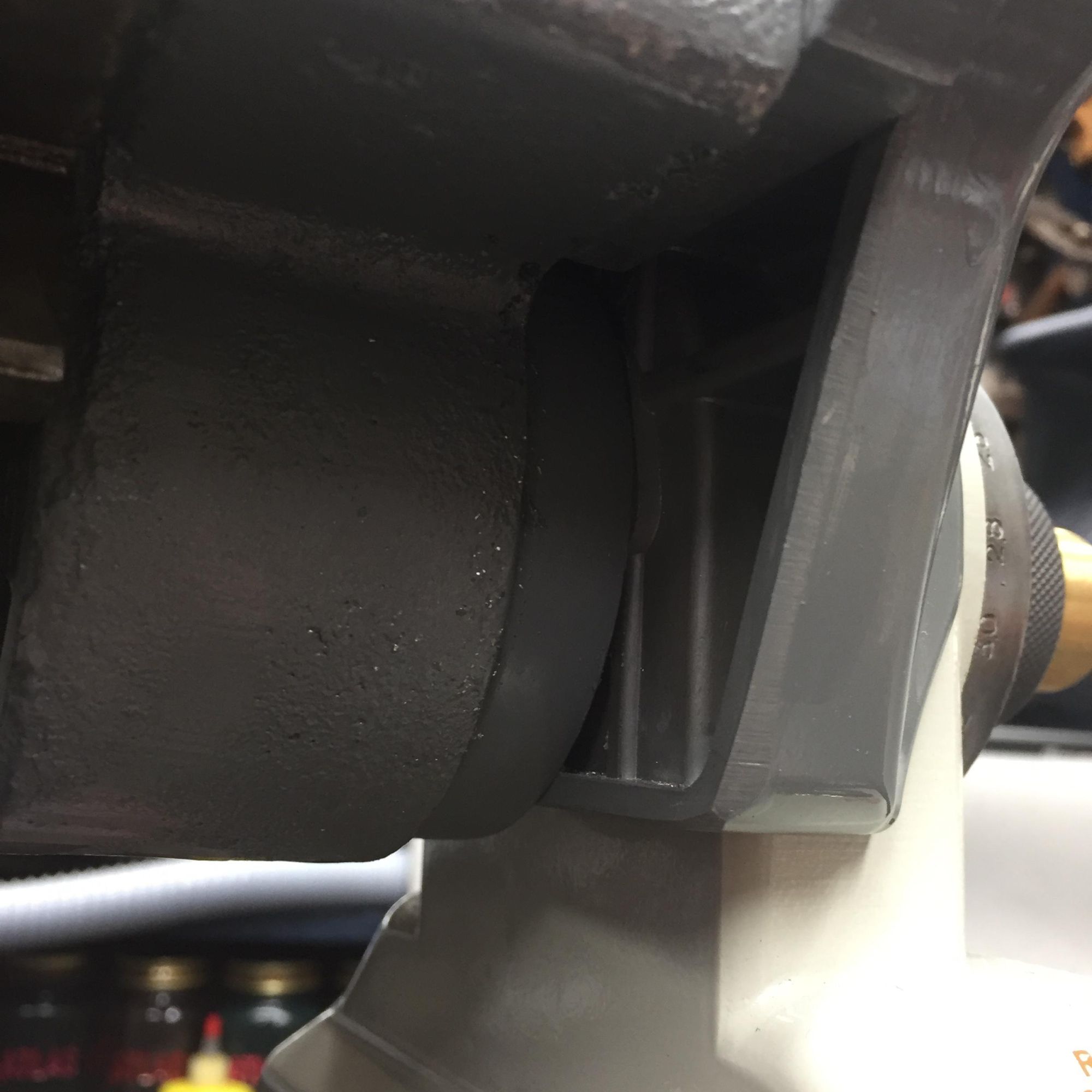

Might depend on what you define as small mill. 13 lbs hanging on the end of the table might be getting up there. Also this PF is hang-down mode. Some smaller mills may have insufficient clearance to the base datum / chip pan for motion range. Just eyeballing I think it would look like this on an RF-45, but smaller yet mills might be tight & overkill. I've seen people make homebrew PF's with quite small gear drive motors, but I didn't pay attention t torque rating. (That would vary by rpm, therefore feed rate too).

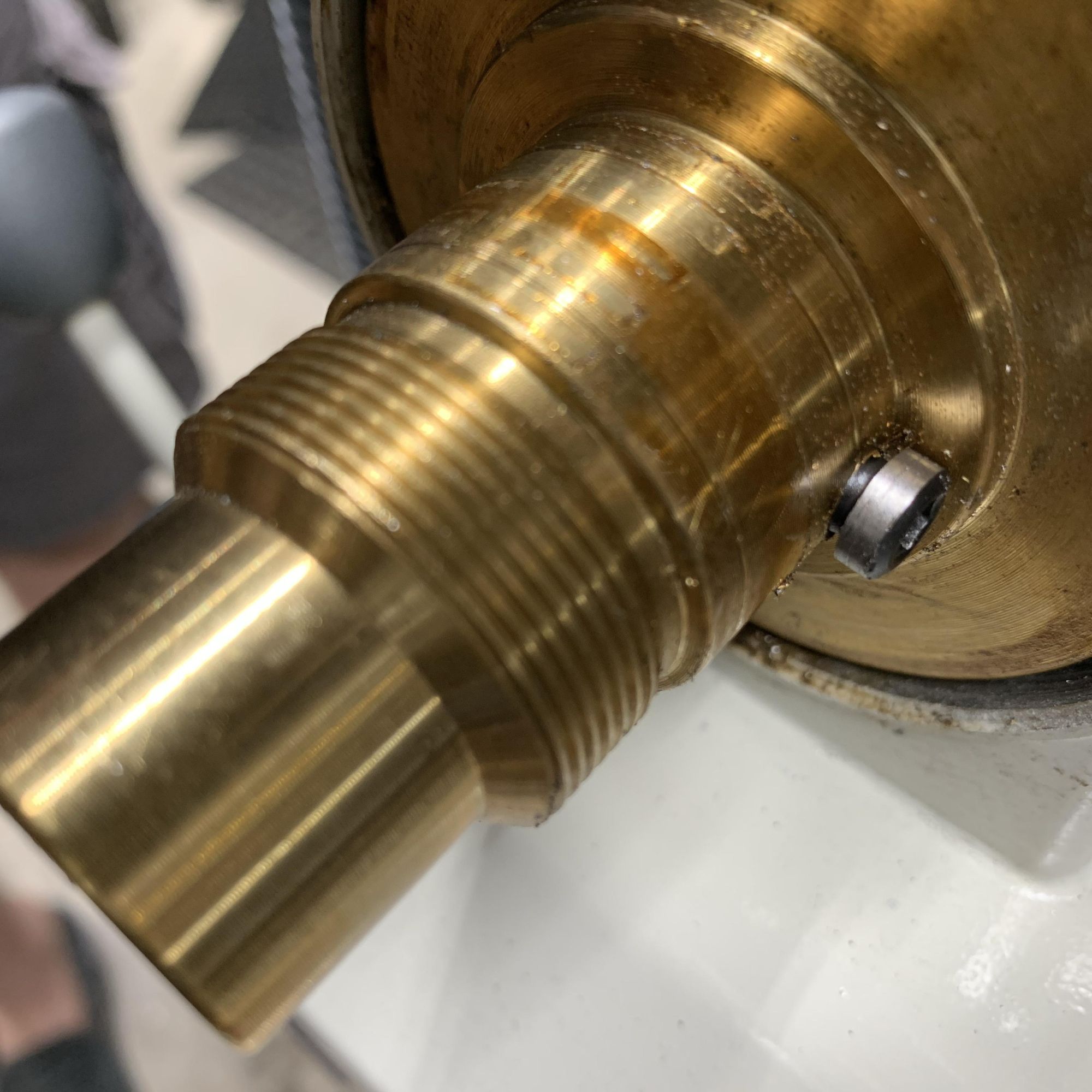

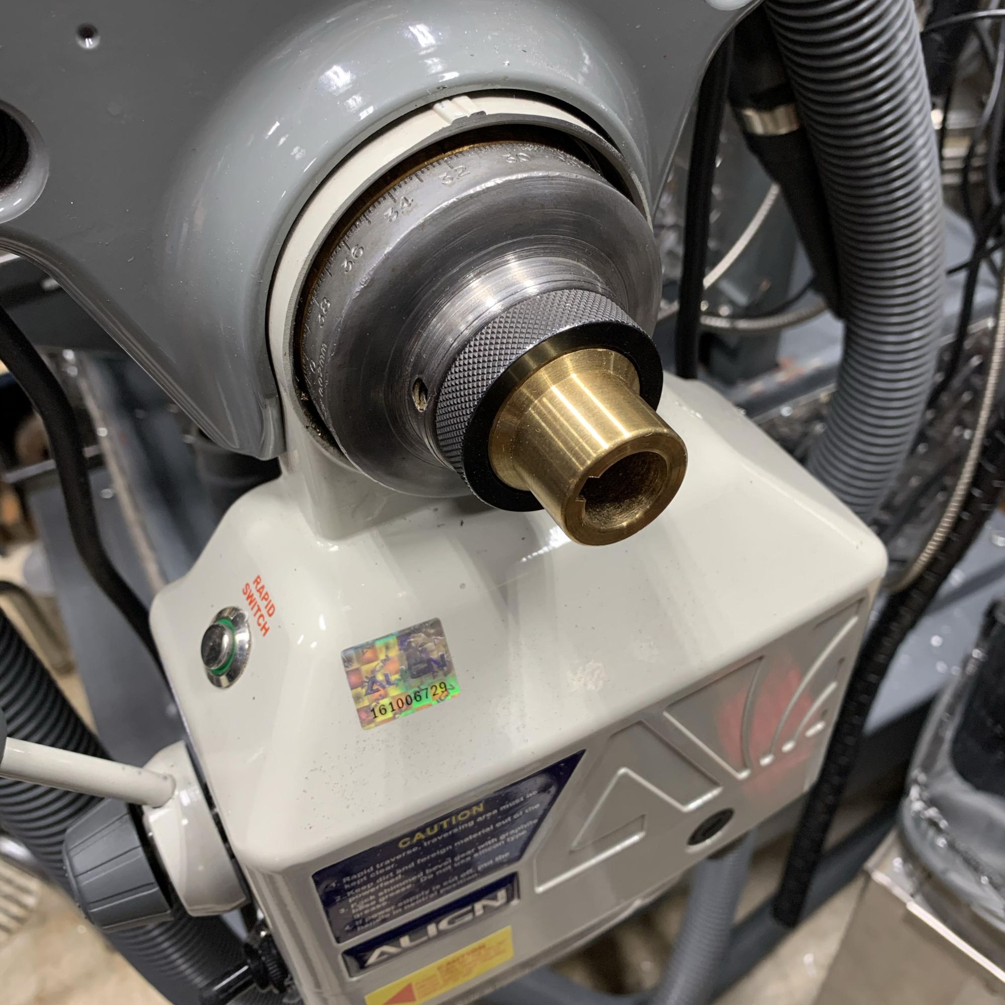

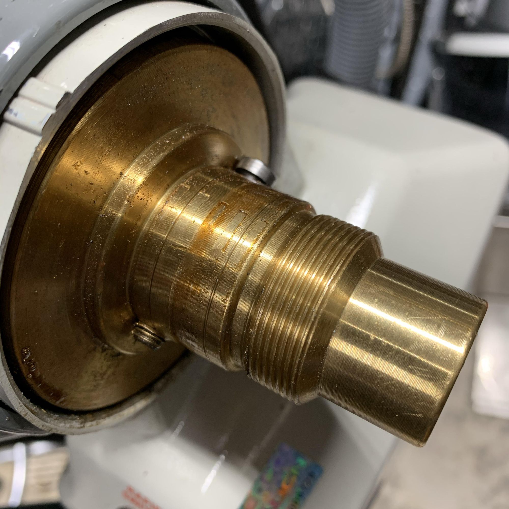

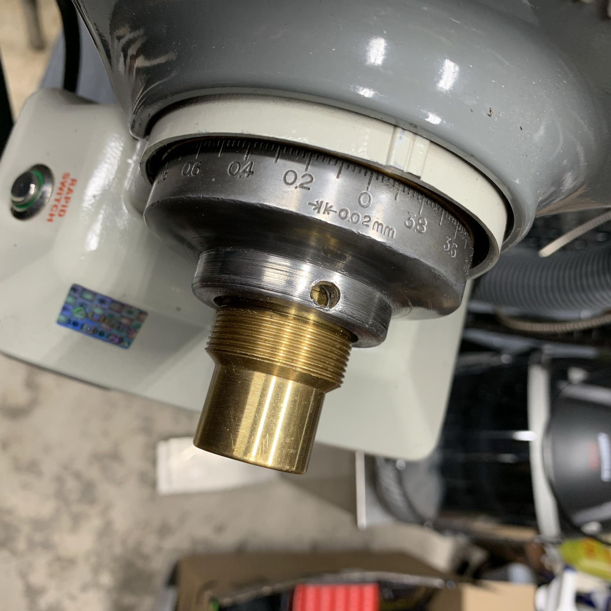

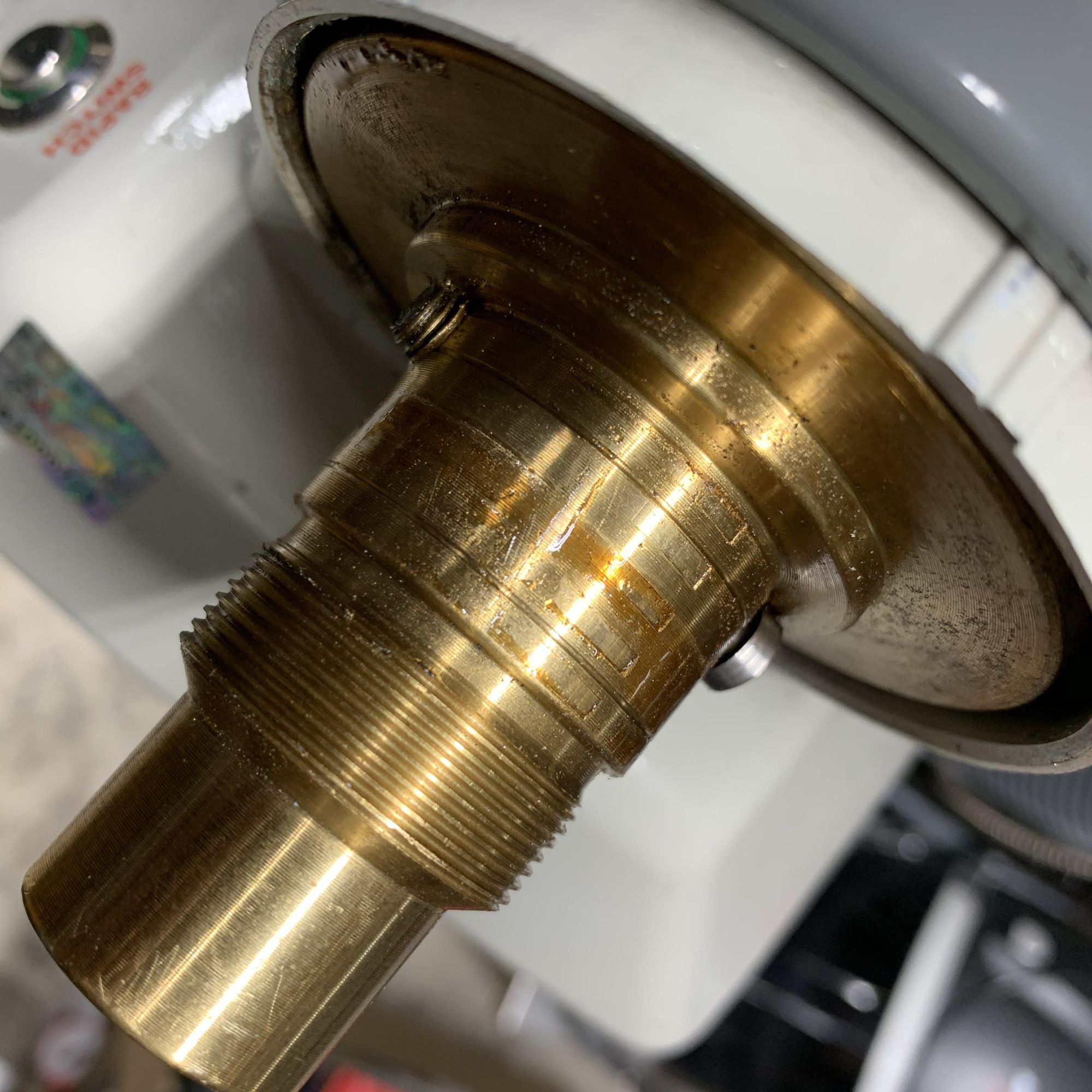

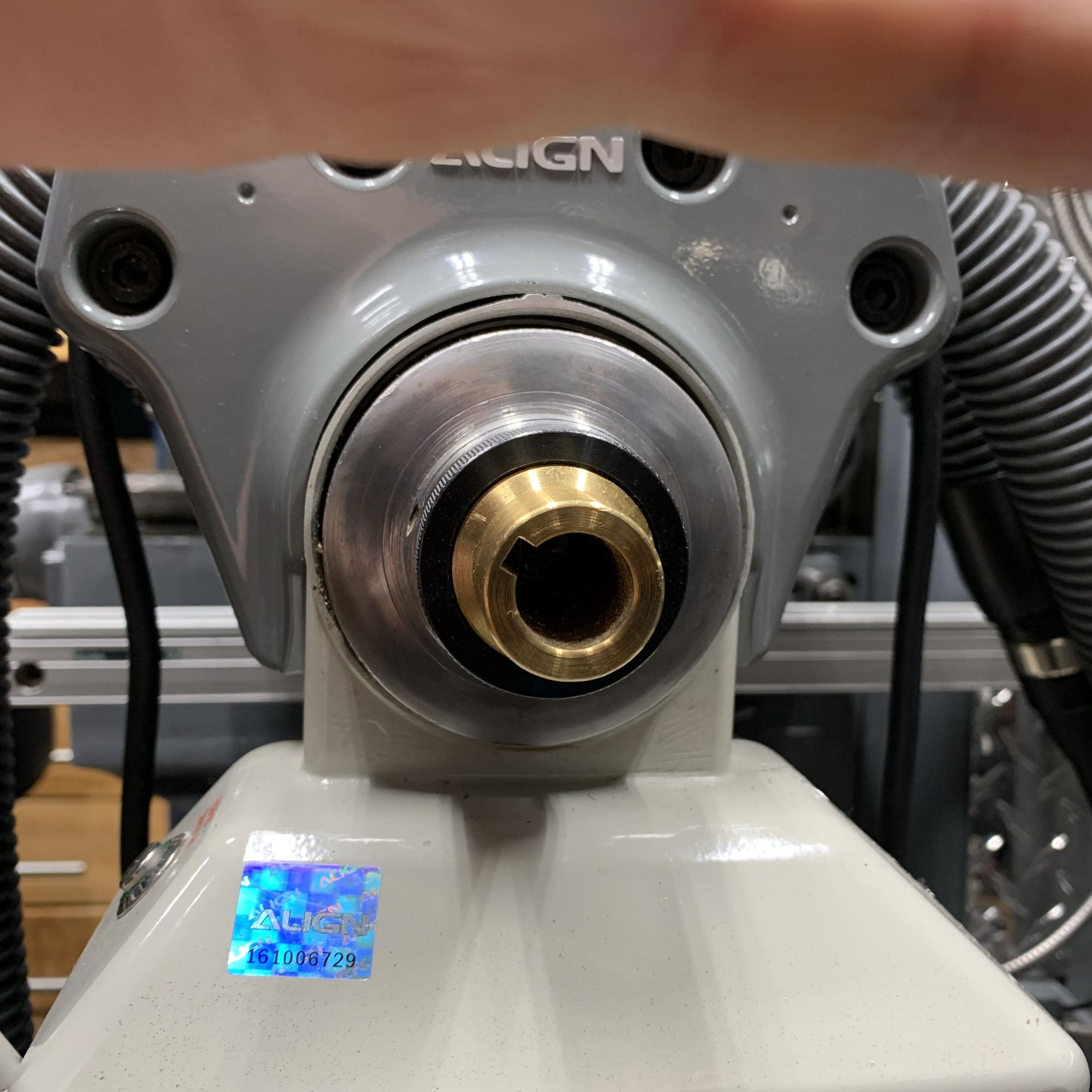

TOBAR - how are you keeping the worm gear attached to the lead screw? The videos I've watched show on a BP the worm gear being held in place by the handle and nut. The handwheel on mine is held onto the leadscrew with a setscrew and yours looks the same as mine. What voodoo have you done to keep the worm gear in place?
Did the two outside holes of the mounting plate line up with existing end cap mounting holes?
I’m a Jedi Master...... Just “Used The Force”. LOL. I’ll take some pics later today so you can see. Truthfully I don’t recall...... these days I’m not even sure of what day it is, or what I had for breakfast let alone the inner workings of the power feed on the X axis of my mill, lol.

Sorry for the delay lads, here are the pics as promised. Turns out I drilled and tapped the shaft then screwed a bolt through. It holds everything in place and hides cleverly under the dial. Hope that this helps.

Sneaky you are,,,, hidden well the bolt be.

There is at least 2 inches from the end of the shaft to where the collar (brass) ends. Turn a shaft, put it into the collar, pin it too and attach the handle. I left the handle off but at the other end of the lead screw it remains. Best of both worlds. I can move the x axis manually from the left and automatically from the right. The reason I left it off at the right was simply a space constraint issue..... “narrow the shop is, make concessions I must”
