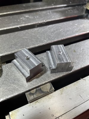

Made it this far before realizing I dont have a drill chuck large enough for 1/2”-13 pilot hole.
Does anybody have preferences on gun-blueing products? Id hopefully find something local and in not too large a container.
Looks Good!
Just leave em raw. Nothing rusts in Calgary except for stuff exposed to road salt.
If you really want them darker. Hit them with a propane or map-gas torch.
You might want to consider knocking all the edge burrs off as well.

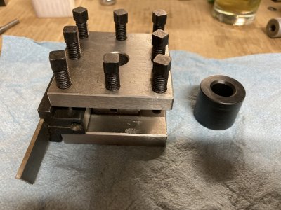

I can't compare it to any others, but I've been really pleased with Jax:
It applies a nice even flat black finish to steel _very_ fast and with just a couple of coats. Not toxic, no smell. In the following, the collar on the right has Jax applied:
I bought a pint ($26) from Sculpture Supply Canada in Toronto which is hands-down the coolest store I've ever been in. I think they would ship the Jax products.
