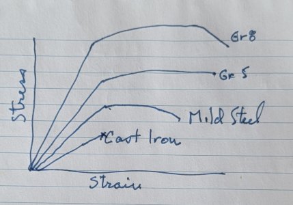

That T-slot in our mill tables is a vulnerable piece of hardware. You can break a piece off exactly as we have been discussing. But you can also break a piece out using a bridge clamp exactly the same way whether or not the nut is through threaded. You can also break it using a simple ear clamp or a bar clamp or for that matter ANY application where the part and table are not in contact with each other in a compressed column. Cast iron can easily handle a high compressed load. It cannot handle a high bending or tension load. The stress/strain relationship for cast iron is not a curve that bends. It is a line that ends .... at fracture.
Depending on the type of cast iron or steel, cast iron's yield strength is about half that of regular steel. In general, roughly 30,000 psi for regular cast iron vs 60,000 psi for regular steel or 130,000 for a grade 8 bolt.
Unless there is a pinched (compressed column) stack of metal between the top of the table and the bottom of the bolt head or nut, a tightened T-Nut bolt exerts the same kind of load on the T-slot as a through bolt that reaches the bottom of the slot. In other words, the half threaded nut protects you from a bolt run too deep, but it does nothing to protect you from a non-compressed joint.
A stacked compressed joint does not try to rip apart the top of the T-slot - instead it squeezes everything together. But a bridge connection, or a side clamp, or an ear clamp does. The worst of them is the bridge clamp. That's those long slotted forged bars that come in the clamping kit. They look like this:
The longer the bridge between compressed columns, the worse the problem.
To deal with this, I developed my own standard rule of thumb for using T-slot Fasteners. Never torque the fastener beyond the strength of the cast iron ear of the T-slot. The torque I use is just 10 ft pounds (120in-lb) on a lubricated 1/2-13 machine screw. I can also use a short Allen wrench tightened by hand but not gronked. 10 ft lbs generates 1500 pounds of clamping force and about 10,000 psi of stress in both the bolt and the cast iron T-slot. Although the T-slot has a, bigger cross sectional area, it is significantly reduced by the slot itself. The stress numbers I chose are conservative. I suppose I could use a higher number but I don't like to push things. I don't have access to any fastener experts anymore and I don't have a CAE Workstation to model the stress in the cast iron T-slot Ears. 10,000 sounds safe to me and 1500 pounds of clamping force per fastener seems like more than enough too.
So there you have it. That's really the reason that I don't worry about threaded through nuts myself.

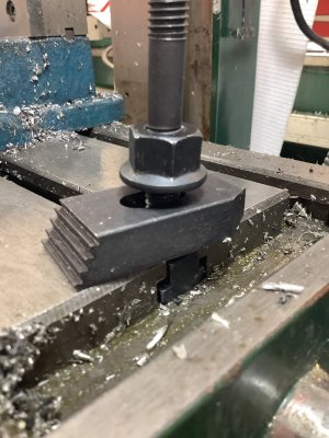

For reference, these are my vise Clamps. They are oiled and tightened to 10 foot pounds each. Notice the nose in the vise groove. What you can't see in the photo is the foot opposite the nose and the gap between the clamp and the table under the screw. No unthreaded section in the T-Nut would stop that table from cracking if I overtightened that screw.
My advice to others is: 1. Use an unthreaded or crimped T-slot nut. 2. Regardless of the type of T-nut you use, never tighten the nut or bolt beyond 10 ft pounds unless you know exactly what you are doing. 3. Avoid high torque with bridged or nose end Clamps or any other uncompressed column.

I have one thing to add to the discourse: when you have an unstaked T nut, lubricated or not, and you use a bridge clamp (as illustrated), sometime the screw jams in the nut, and only turns in the t nut. This is caused by a little too much angle on the bridge clamp, and is far too common. This causes the 'terrible stud' to turn as instead, causing the stated problem.
Where possible (such as mounting my vises or index head) I *always* use Grd 8 custom length bolts, with custom washers. It is only a momentary sacrifice, but the bolts and washers stay forever with the vise, and there is no jury rigging. You always have the percect mount at hand, and is a lot faster than hunting down a flange nut and correct stud from the kit.

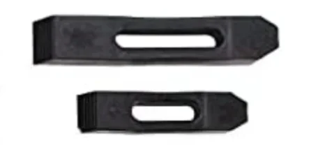

T-nuts and strap clamps can truly be your friends, just takes a little lateral thinking. To drastically eliminate the tension load on the cast iron t-slot, use a short clamp against the table and a bottom clamp nut. Also means the threaded rod doesn't flop all over the place and disturb your support arrangement when you loosen the top clamp nut.
Perfect example of a fully compressed load setup with no danger of breaking the cast iron.

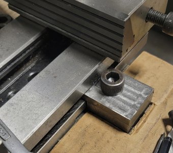

So this inspired me to make some t-nuts. I had some bar stock that I'd brought down to size breaking in my little power hammer a while back, and I figured this was just the use for near-dimension stock.
u8WXXF4LWvQ9xVKomMN-JgRKxIeL4KyT_CQ4pW55rZQd7TEGsHkzMLI7T7KmdkY0oG0kLCcsDCMfXyXpSYEt0vIXrN2VwluJmsKddGc925b3enGwEg6EhNhoNk-qPfWe6FT53qaE-o6B1k7ilRpA-i7aXZlZw79mWhZ50T1-wbaeZ69MK6FfNjt694J0_ckNJN34xqT7pMqvcJtS1OwvBLHmYX7ZJWyCng8qy_i1tS-y64ig_ievec9V3Lk_RxnlZsiXriumq8MfvJqlKPLduJwBUxM1StEBzhVlkqyQL-HVWlKNABy_WEQSf37S5eLHNYV7TueWW95W1KltEz6aev8Gpw_XUmfn3CIjC8_q52gefSW1YPTamZLTH5QQ_pVjkxpHvKk06bqQQrsiB7ZocXMbpA3EDG8yuQq_JbMOu3LlmE1iH11IVQ4cf53jAkVRwBtWxHPl9v_Dy4YMGRB9U-EgqsYhBAfY145Q5kIWr49Ac1nc7aFELOjeHmV7CYiG0RWe6WpdrLvYENDddTmipjE5Sh5IhpN1qhLlhv3Dmehx1RBc9gZNA8nAHHN8wJHtRlpjRvzcHBwr5UU1nuqhvNGSWF5MM49oO2naJQ-cPDJ36VedBjyGXUldBxZwYKXZC1YLaC6fYYVZTantpHxj8ZPxD7ts-hgN8oMfuPYyXMAwW22RaBE9NyRlzZ7qWXp1bgp7xyuQBOBuNibTHqtv4zwH_FKAoHwZnhCv6vozBcFX7I3Im_4jSIPTzHUO=w3616-h2722-no
Not the prettiest toy soldiers, and, frankly unnecessary given I have a stap set... But I hit *almost* all my dimensions, including fixing a couple of close calls in the backlash department.
In the strap clamp horror stories though, this seems like the most over-worked length stop possible, but I had no way to hold a stop inboard of my vise jaws to take the little blocks to final length:
0zWl8bfr24yLln2sCyppHS4H4hkYaIppx4U6_ZFp354epMyK_rVNfNsloy5ImFlbFaoD8WEiETqL3bNxTywp8DpaLwYRm03r5gq0CTS4MbNLeVqVQwQe6JIYBUN0B9heUNfRaMqgC4uph2EGXwMLAzdHVNJUCMPoZJWG1YzWE8h1uLeV8LnH7dkJMBXHcQWIGiohMZfCV_7CBxPxojVeeQUXdM9Dew7diEjPg3ktY4YgKqj7VjKP0dZ0LXw14WEtcT6MVKhGvrPDcHFmQ9QkzpUhrYjAMNaETWGtWe5pXmgJbLJFbCQOkTgBqMLxe023bDmOU1InFtvjCnr2xohlN9Dg3WNWl65bbbeic6NWPKkrchV7p2csanm29cpGzE1_c7CRy7khpwSx4Y30BCsCUFoFhsTtPugIK7tXo2aB0D9fIEizQ18kISBvkWHVw9YAgl8KS9yX8oUPFWSgLl6nGWKDqXcMz8kydZikiqAMTvQ5VvnyIsZbQsZWuE5mdknktmtWPfucHjzhd_nvlxHV7Dx02QTGSilesRh7D2B5nN49gUl-DxSGPIiVo5Y3pkhwqgJMMWpEWFjKllojeYE0uP16MBClCE8LIRHwrAHc2IW5EkS2iSUSHQKqWDI9Fs-FuHF8Wu6Gj1ZGULLIM6yLn_3z4YNVHDW8jJKWibVwZddCD_eEKmYyZ5TZF-NokJfLiS2AWbochvgKRHqCN_jxOnchRnuiYw3tB72ZpSThkuX8XEgGGjDT0MQaqulZ=w2050-h2722-no
In retrospect I should have made 4 t-nuts 1.25" long instead of 5 at 1".
Still need to get some acetone and some blueing compound.
