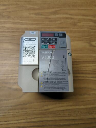

Most guys are way better off looking for a reputable brand used off eBay.
For example:
That one would be an awesome drive for someone.
Yaskawa has on their website under the v1000 model: failure rate 1 in 10,000.
Mtbf: (mean time before failure) 28 YEARS.
A similar drive from Mitsubishi has a 5 year warranty….. they post average lifespan with normal use (example of normal use: running in a factory 24/7) for their machine drives: 10 years.
Amazon drive vs Japanese name brand drive, or most other name brand drives is apples and oranges.
The Japanese drives are typically bears to program though…. European/American companies (Teco/Schneider/Vacon)usually have an easier user interface…. But almost always less warranty.
