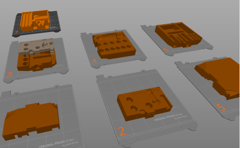

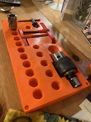

Recessed magnets on both sides. But protruding magnets might be better Peter good idea.

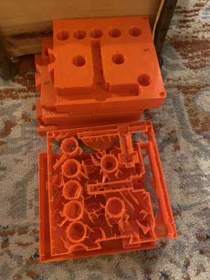

How do you do a protruding magnet? And isn't the weight of the parts in the tray more than the magnets can handle?
I didn't realize that printing could leave a hollow part so empty without support. Very cool.
I like the custom Allen Keys. Where do you get those in individual sizes?
Can that handle 2" deep or even 3" annular cutters?
Protruding magnet - I might pile two magnets together, glued, and glue them into the hole. The magnets won't hold the tray of parts to the next tray, it's just trying to keep them aligned. I put hand holds on the bottom of the trays. The allen key handles are from printables and I stuffed the provided keys into them. It's a little wonky as the allen keys are not straight. I'll have to bend them to 90 degrees. The lid clears 2.5" cutters. You could scale it in the slicer for 3" cutters. If there is interest I'll post the .stl files.

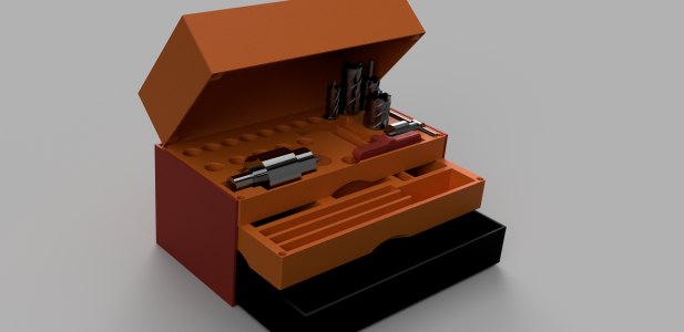

As I've been printing these trays and trying to figure out what to do with them I realized - JOHN! - it's a tool box! So I'm going to make the tool box frame out of some plywood. Lid needs hinges. Need a handle on top, and a latch to hold the lid down and keep the drawers in. Still mulling how to do that...
