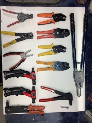

With the spectre of wiring up the electronics cabinet for the mill conversion I splurged on these Klein wire strippers.
Those look a little different than the ones I like. My Klein looks like this:
It strips with a staged ratchet action. You insert the wire to whatever length you need into a set of jaws that range from 20 gauge to about 10. As you squeeze the handles, the Jaws close around the wire and cut through the insulation. Then they pull off the insulation as you further squeeze the handle. At the end of the stroke, the grips release so you can remove the wire and the insulation pops off. Then the Jaws snap back ready for the next wire. There are also a number of wire shears for cutting wires to length.
I got a different brand 50 years ago and have loved it till it disappeared. Prolly "borrowed" and never returned. So I recently bought a Klein like the photo above.
I agree with @djberta , these plus a ratcheting crimper like this are both essential wiring tools. The Jaws of the crimper should look like this:

This is a set of removable jaws from a crimper. Mine are not removable. The important feature is the folding facility at the bottom of the crimp that bends the ears of the ferrule inward so the crimp ears size to the wire with an ideal connection. Simple pinch crimpers do not have enough contact or tension to hold the wire tightly enough to keep the wire from sliding out when pulled. Normally you squeeze them until the release activates. But sometimes that doesn't work for a thick wire. There is a manual release lever you use when that happens. My middle son broke the manual release on mine. So every time I use it, I have to pray it releases automatically.
Yet another good tool to have is an RJ45 crimper for terminating ethernet cable.
Lastly, a pin release for electrical connectors.
Unless you're doing the Dupont crimp headers which are so popular in Arduino-land. Those need a different two stage geometry. I have the unit below to do those. It was a PITA figuring out what hat was wrong with my crimps....
