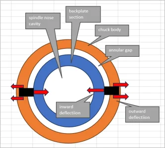

My logic: set screw gets torqued in to dial TIR. Once the screw bottoms on backplate boss it goes into compression as its screwed in. More torque, more compression. The reaction forces are outward along set screw axis via the female threads, which are connected to the chuck body. So the chuck wall deforms elastically outward as shown by DTI on RR video. But the backplate boss is seeing the same set screw load. It is a plate of steel with a big hole in the center. It wants to contract inward but hole is entirely filled by a meaty spindle nose offering support. While its on the lathe. Now remove the chuck + backplate assembly. No more spindle in the hole, so no more support. Why wouldn't the backplate also be free to distort to some degree over time?
Hmm, I wonder if I could just measure this the exact same way? Off-lathe distortion wasn't of interest to Robin.

Sketch of what is my brain. What am I missing?
In my opinion, the only thing you are missing is time. The distortion happens immediately, not over time. The stress and strain relationship has no time variable in it except on extremely fast scales (speed of sound in steel), and extremely long scales (thousands of years).
However, I have zero problem with a shift taking place when the chuck is removed, nor again when it is installed. These may not be mirror images due mostly to friction. Therefore, there may be some hysteresis in the distortion.

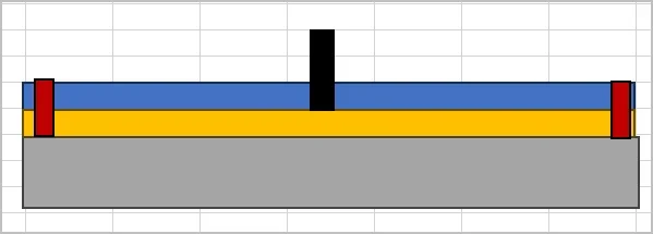

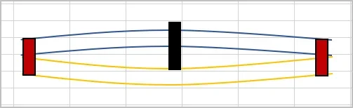

The blue beam is riveted to the yellow beam on the ends (red). The yellow beam is fully attached on bottom surface to flat granite earth (grey). The blue beam has a threaded hole with jack screw (black). Lets say for argument the beams are same material & dimensions so my cartoon looks reasonable.
We jack on the bolt, blue beam deflects/distorts upward, yellow beam stays put.

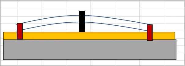

Now we release the beam assembly, yellow no longer connected to granite earth. The jackscrew remains with same force & the distance between the beams at the jackscrew is the same. But at this 'time' the beams stress relieve themselves. Since they are pinned at the ends & have equal opposing force mid span, they now both take on a different shape. The blue beam has relaxed in curvature but the yellow beam has distorted. If I position the assembly back on flat earth, it no longer 'fits' because yellow is now curved.
So the analogy is: blue = chuck body. Yellow = backplate. Grey = spindle nose completely filling & supporting backplate center hole. Black = set screw. White in the middle is annular runout gap. The 3rd picture represents when the chuck is removed from spindle nose & the 'time' it distorts.
Now I could theoretically force the beams back as they were, conform the yellow to flat earth again & it would look like middle picture within elastic limits. But now the analogy is getting a bit weird because we are talking about a no longer round tapered socket (backplate) socket trying to fit a round tapered spindle nose, being sucked in by camlocks....

What you just described is almost EXACTLY what I suggested and was quite comfortable with. The only major difference is that you only focussed on distortion in the axial direction and I could easily see other forces experiencing similar changes.
Theoretically yes, but not in reality. As you describe, the no longer round socket and other dimensional changes will supply friction that did not exist during the the pre-balanced condition. These friction forces will generate hysteresis in the forces and resulting flecture of the parts. No matter how solidly you mount the backplate, this friction induced stress will result in distortion of the re-installed chuck that wasn't there when it was first installed with loose jack screws.
