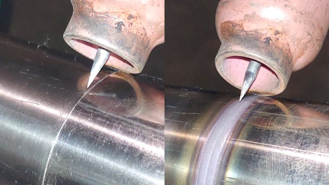

I've done some thin wall stainless in the past and a gas lens with larger cup is your friend worth the investment maybe run you 100$ for couple with cups/lens from Praxair even cheaper off Amazon. #10 or number #12 would be good size.
Another tip if you have thumb switch or peddle is to use it like tack welder more or less but that's the slowest method and pinholes will probly haunt you.
Better method that you have been playing with is no filler method or little to no filler anyways. You want to start you arc and fuse the 2 pieces together then add a dip of filler at the start then just drag the puddle. Moving fast as possible well managing a tight arc length a fast pulse can help with this but you will still want to move fast and smoothly just be careful not to over do the stitches maybe 1" at most as warpage will be an issue. But you should be able to hammer out in conjunction with heat shrinking the panel with propane torch or tig if careful. There is some good YouTube videos on the topic.
As another tip for tungsten stick out too tell if it's too far and not getting enough gas coverage is the tungsten will get a blueish black oxide on it but can also be a post flow issue isn't set long enough aswell if your running tungsten hot.
Also I would recommend 2% thoriated as my #1 choice then or 2% ceriated or 1.5% lanthanated as my #2. The thoriated holds the sharpest edge for longest before splintering with use.
The advice that @phaxtris and @Proxule offer is good advice I tried not to repeat to heavy as they beat me to the punch
Your easiest method which was mentioned is still probly .23 hard wire "ER70 S6" but if you plan on doing may hammer and dolly type metal finishing work it doesn't form well compared to Tig
But from what Ive seen your on right track don't worry too much on adding filler as there isn't much to fill with light gauge material I don't feel it adds much benefit I think you will get more benefits having good gas coverage or maybe using chilling bar if possible.
@phaxtris I would try same pieces using the dip then drag method it will surprise you to how little filler you need. I would do up test piece but we're I'm working now doesn't have a Tig as we just rent most of our equipment for turnaround or maintenance.
Example of fit up your looking for and what a dragged weld looks like on stainless anyways. steel wouldnt be as pink will just be boring and grey. From a picture off google. Looks like #8 or #10 cup 1/8 tung and .50 Sani pipe SS they are also using a spinner
Edited.
Forgot to mention I would try sticking with 3/32 or even 1/8 tungsten it helps dull the power of arc and let's you put less heat into part as heat is your enemy even at low amps. You Can use the small stuff too but may find it easier to keep from blowing threw and if your machine only goes down to 25 can kinda help get but more range out of machine amp wise
