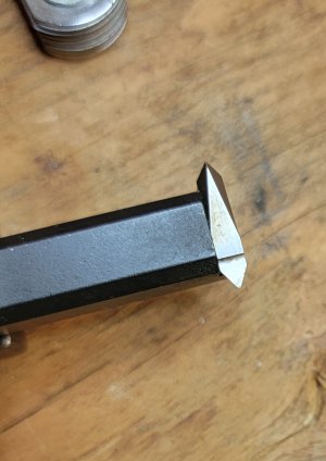

If it weren’t for having to grind tools I would almost always stick witH HSS. With HSS you can shave off a thousandths with a sharp too. I can’t do that with carbide. With my Southbend it either does’t cut or takes off 5 to 10 thou. On my SM it will consistently take off about 5 thou but won’t shave off much less than that. This is all with regular inserts.

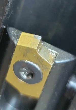

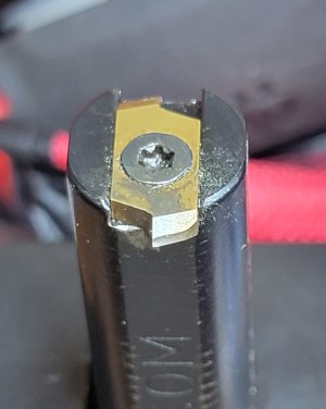

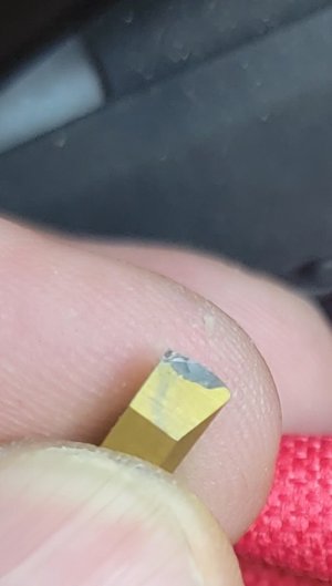

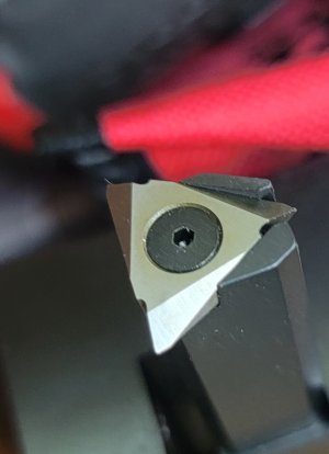

@DPittman & @PeterT - Here are photos of my existing Mesa Carbide tool inserts. It's easy to see how they failed.
And here is a photo of a cheap kit insert. Basically the same type of failure.

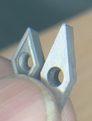

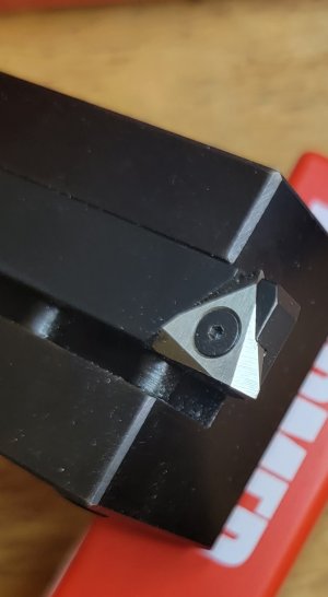

Now compare that with the ARWarner HSS Inserts with maybe 20 or 30 times the number of jobs under their belt. The flat below the tip is original and intentional.

For regular non-precision threading, I just grind some regular HSS tooling. As soon as I get some of the regular carbide threading inserts like Peter recommended, I will try them and post again.

I've only tried the triangle hss inserts from AR Warner but like them also.
@Susquatch that is classic carbide fracture. I would share your reluctance to use inserts too if that was a consistent outcome. The key question is, how is it happening? Typically its alignment, chatter, interrupted cut, flex, slide or play anywhere in the supporting components from the holder through to the ways. Easy to type, maybe not so easy to diagnose. My gut feel is its a feedback loop. Initial alignment is good, speed & feed are acceptable. But something is allowing it to move in & out of the cut & brittle materials like carbide just don't like that. The HSS may be the identical form & sharpness & subjected to the forces, but just more tolerant. I think if you fix the problem, even the HSS will look better that they were or at least cut more efficiently.
I'm not familiar with the Warner system but I suspect its good. For $20 of disposable R&D & would try an Ali lay down threading tool. Ease into it with fine threads & something nice like 12L14. If it starts chipping & degrading too, then my assumption would be some kind of other machine/setup issue going on. If its good initially but issues arise at certain DOC or material types, then the focus turns back to insert tooling. Not knowing your machine, but if the leadscrew is wearing & locking isn't done, that can have a big impact on threading & parting which are kind of devious cousins.
