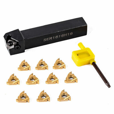

I'm interested in gettng some carbide insert tooling for threading, but 'can't make head or tail' of all the choices. So I would really appreiate specific recommendations - not just the store, but the actual insert and insert holder/tool. Thanks in advance!
What size tool holders or tool bits is your lathe capable of using?
It's a 7x14 lathe with OXA tool post and holders. To align to spindle center, it's easiest for me to use 8mm tools; 10mm usually can work also. I have some insert holders and inserts for turning, just nothing for cutting threads. I'm using a home ground HSS 60 deg thread tool and it works OK but I find it tricky to get the 60 deg. angle and nose radius exactly correct.
What store did you get your inserts and holder on Ali?
I might not be all that helpful but I'll try. I went back to my notes & looks like I got my external toolholders & inserts from 2 stores: Leader & Beyond. I pasted the store home page below. But this is going back 3-4 years ago likely dated information. Seems like some Ali stores are a bit nomadic & searching for stuff can be a PITA. Just now I typed in one of the common shanks SER1212H11 & got many hits (attached screen grab), but most of the stores I don't recognize (mostly because I haven't bought any recently). But seems like the same stuff, holders 8-12$, pack of 10 inserts 30-40$. Sometimes the same sellers can be found on Ebay, but pays to check prices & shipping etc.
Leader
Beyond (now Oyyu?)
Ebay random hit

Its slowly coming back to me. I stayed within the (10,12,16mm) shank sizes because those fit my tool holder & do not require anvil (green shade on matrix). This system is consistent with Carmex where bigger or different inserts can benefit from anvils to alter the effective angle. It gets confusing but generally those were outside my application.
I had to chuckle looking for the Oh-so-convenient tool shank cross reference table buried way down the Oyyo/Beyond link. Like don't bother us with your questions. Just waste your own time reading our crappy website & just click buy already. Sheesh.
Also internal inserts are different than external! (personally I think there are better options like Ali 60-deg carbide bars to accomplish threading but maybe that's biased to my own work)

Thanks, @thestelster . I appreciate the suggestions. The "tons of others" is the problem! :) I ordered a SER1010H11 holder and some inserts from AliExpress- with cheap stuff I can afford "buying the wrong one" mistakes. Finding a supplier for 'name-brand' high quality stuff is a challenge, and when I do, the prices (and shippng costs) often tend to be breathtaking. :)
