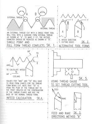

@Susquatch: Please refer to the attachments for your reading pleasure. There are "preferences" for how you set up and make threads, and indeed there are many different threads that are cut and the profile of the thread required will possibly dictate what set up is required. clearance for the tool, load, chip removal etc etc will typically dictate what is necessary for proper threading.

I found two things of great significance to my quest in your documents.
In the first document, the author describes how we arrived at 29 vs 30. Basically he confirms what I had surmised earlier. On the earliest lathes it was not practical to set a precise angle of 30 degrees to cut perfect threads. But it was soon discovered that 29 degrees didn't need to be precise. 29 degrees solved the problem of precision by cutting the majority of the work on the leading face of the cutter and cleaning up the remainder on the right face with a very light 1 degree progressively deeper cleanup pass on the right face.
As @Dabbler said, a precise 30 works just fine. But 30.2 would not. In the absence of an easy way to set angles, machinists just fell into the practice of using 29.5 (or at least some slight angle less than 30).
The second source contains a reference section with information in it that I have never seen before. I "believe" it points to the reason for doing the 30 degree compound cut.
It is buried in the attached screen shot and discussed in the text.
Note the top rake on the cutting tool used for 30 degree method vs 90 degree in the top right drawing. The author claims that a single point tool that cuts on both faces must be flat with no rake and this results in chip clogging in many cases. A double rake tool is not possible with conventional grinding methods of that time. However, a tool with a top edge ground to cut primarily on the left edge never does this.

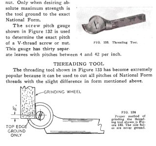

It is worth remembering the old lantern style threading tools of the day.
One can, easily imagine the process of cutting even moderate threads with a lantern post tool like that on an old lathe like my 1800s FE Reed.
