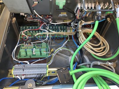

All connections to the console are complete.
The IO board (x2/y2) inside the operation table is used to control the indicator light and switch added to the operation panel, and the control cabinet has a group of (X1/Y1)IO board, which is an expansion accessory for the numerical control system.

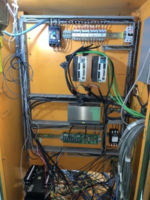

The control cabinet also needs major changes.
Servo control area circuit finishing.
Add a filter (installed at the output of the isolation transformer)
In recent years, the circuit transformation and learning have made me progress a lot, which has solved many problems in previous years!
The auxiliary function logic control circuit is much simplified, but still requires a lot of line arrangement.
This is the first time to install the numerical control system, need to consult a lot of information, also need to learn a lot of new knowledge, so the progress is very slow. I need to minimize errors, and I need to optimize the circuit and add some additional functions, so it will take up a lot of your space, and I hope to get your suggestions.

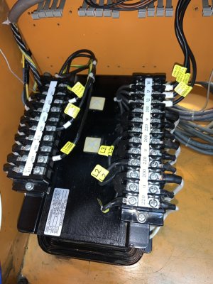

That's quite the filter. I've never seen one like that. Usually an isolation transformer doesn't need one.
Was the output too noisy without it?
The servo drive is AC220*3, and we are accessing AC380*3, so the isolation transformer is definitely needed, and there will be various clutter interference in the circuit, adding a filter should be beneficial. Also, I happened to buy some filters at a very cheap time, so the addition can only be beneficial.
I think we are having a small translation problem. I'd call that a step down transformer, not an isolation transformer.
I can see why a filter might be useful when used with a step-down transformer.
But still, it is a nice filter. Great find!
Indeed, we can choose a self-coupling transformer, or we can choose an isolation transformer, because everyone uses an isolation transformer on CNC equipment. I understand that it is safer and more pure, and I also think that the self-coupling transformer can be used, but it should also be better isolation. It is better to follow most people's conventions - unless I can find a better solution from theory and practice, or I have enough cases to prove that my solution is better.

Today, the transformer cable was replaced, the original cable was 2.5mm*4, because the planned is a 3-axis motor, so the cable is a little small. I use used cables, but the quality is very good, I use mostly bought old cables, they are cheap and oxygen free copper.

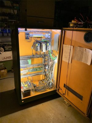

Dig out the LED light strip bought a few years ago: 12V~0.37A, install the cabinet light first.
2 strings of 6 parallel. Total power approx. 54W, single side power 27W... It's so bright,
you don't have to use work lights. Install an extra travel switch and use the cabinet door to control the light switch.
I changed the opening and closing function of the cabinet door, which was supposed to be for security control, and I used it to control the cabinet lighting.
Finally know why the cabinet interior is why the choice of orange, which will make the light better reflection, make the interior appear brighter, conducive to the maintenance of the cabinet.
