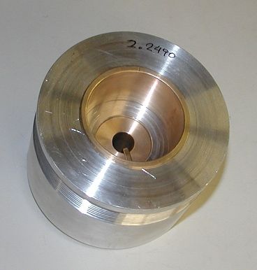

It’s time to follow up on a project I started a while back that started out with making a bushing with a fixed internal key. That thread is here:
Keyed Bushing Thread
The bushing was the starting point for re-powering the drill press my father made from scratch, including castings, about 70 years ago. The project is adapting a treadmill motor/controller with the objective of increasing the speed range and getting rid of a two stage belt drive I had added some years ago.
I wanted to use the multi-vee drive belt system the treadmills have so I needed to make a new driven pulley, the challenges there were cutting the grooves and fitting a brass plain bushing/bearing in the pulley. As it turned out, once I ground a tool for the groove profile, machining it was easy, about the same as cutting a thread without the helix.
Fitting the bushing was a bit of an exercise in math and careful machining. I was aiming to hit the same ID size of the existing bushing and cut the OD so it was a press fit in the pulley housing. If I recall, I aimed for about .0025 for the press fit. I actually fit the bushing in the aluminum pulley using differential expansion (heat) rather than pressing it in.
After doing the math, I put the bushing in the fridge and the pulley in the oven and the bushing just dropped in loosely until the pulley cooled down. I think I used 400F/204C. That was my first try at doing something like that so I was quite pleased at how it worked out.

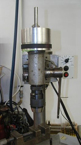

The rest of the story is the treadmill motor and drive electronics. I grafted the treadmill adjustable motor mount onto a plate that bolts nicely to the drill press bracket and adapted the electronics.

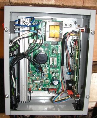

The treadmill uses a PWM controller that gets its speed setting inputs from a set of analog membrane switch buttons so after a bit of tracing the circuits of each button press I was able to mimic them with a single button and a rotary switch. I also incorporated a dedicated switch to replace the STOP button of the treadmill.
What this gave me was the option of up to 9 speeds ranging from very slow to fast plus fine adjust and all I had left to do was measure the speeds and mark my switch settings.
There are several reasons I went this way vs. an SCR controller and a potentiometer etc. First I wanted to use as much of the free material I salvaged from the treadmill as possible rather than inventing things. I also didn’t want to break new ground for me like understanding SCR controllers.
Using the control electronics from the treadmill takes advantage of its built in safety controls. I had read the article by Days (Dazecars.com/YouTube) where he blew up the same power board because his band saw grabbed and stalled. He didn’t use the treadmill control board.
The complete treadmill power & control system gives me the overload safety function that's built into the control board. If the motor is overloaded the controller senses this and “folds back” the drive power until the overload is removed or the machine is shut down.
I mounted the power & control boards in a 8 x 10 x 4 metal enclosure made by Bud Industries that I bought on Amazon, amazingly cheap at ~$20, delivered.
The “finished” product looks like this (Awaiting painting and a belt guard….):

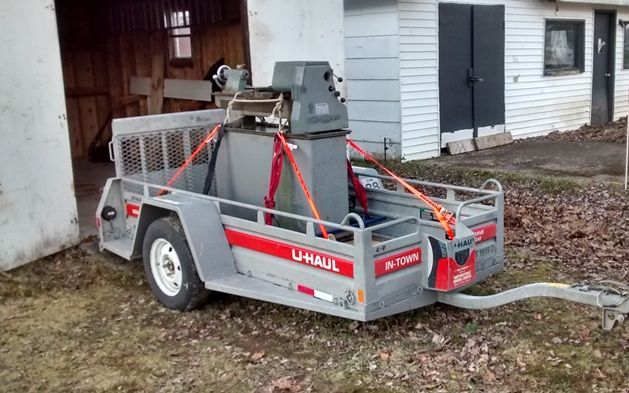

I've acquired the 1120 series 2000 Standard Modern lathe discussed THIS THREAD and I'm making this the home of discussions about cleaning it up and bringing it back on stream.
First off, I went and picked it up about a couple of weeks ago. I rented a U-Drive pickup and motorcycle trailer which is lighter than their dual axle trailer. It turned out well because to load we had to move the trailer across the lawn by hand and then hook up the truck. The lathe was in a shed at the back corner of the lawn with trees and clothesline poles providing obstacles. Luckily, while the lawn wasn't frozen or covered in snow it was firm enough to drive on. I did have to drive around the house & over the front lawn, staying away from the septic tank, to get back to the driveway!
With a bit of finagling we put the lathe on the wheeled dolly I had previously built to move my First mill and easily rolled it up on the trailer for the trip home.

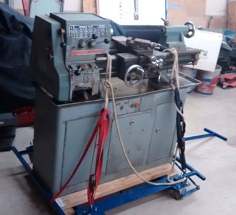

After a bit of digging in the basement, the seller turned up a 1HP, single phase Baldor motor, a couple of well used 3 jaw chucks, a Rohm ½” drill chuck/MT3 arbour, a couple lantern tool posts and a of bunch of matching tool holders. I am missing the curved boat(?) from both though. One chuck has a D1-6 backing plate but the pinions are cracked, the other has no backing plate.
Generally the machine looks OK although covered in a thick layer that looks sort of like Cosmoline but I imagine it’s just old, dried oil. The ways generally look good although by the tailstock will need some clean-up. I got to lift the cover of the gearbox and it has a fill of thick, clean looking oil and everything inside looks great. What I could see of the QC geabox looked just as good. Cosmetically someone seems to have partially painted parts of the machine (with Tremclad??) so I’m thinking eventually I want it all one color.
Big picture: I think I have acquired a machine in fundamentally good shape with some clean up and TLC required.

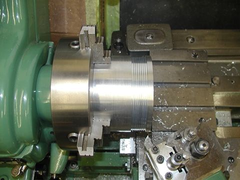

Next up was getting a chuck on the machine. I had a pristine Burnerd 4 jaw and the well used 3 jaw that came with the machine gave up its back plate for the Burnerd. I actually managed to get some use out of the sketchy lantern toolpost that came with the 1120 after making a new rocker for it. Crawl first then walk, LOL!
Next up was making an adaptation that would let me use the Dicksons toolpost from my Myford “for now” until I came up with something better. Then I roughed out a backing plate blank for the Atlas chuck I picked up thanks to a lead and some help from this group. (Thanks guys!). By then I had made up a CAD back splash to keep from spreading chips all over my shop.
After spending some time on the mill laying out the chuck mounting pattern and the D1-4 stud layout I set the mount up on the Myford to do the final bore and mating taper.
I wound up making a new connection plate for the TTA because I ran out of travel with the original because I had offset the TTA slide to make room for the DRO scale. The upside down boring bar is for the same reason but on reflection I probably could have spun the tool holder around to gain back some of the travel. Getting the taper fit right was a bit finicky but in the end I’m pleased with how it turned out.
