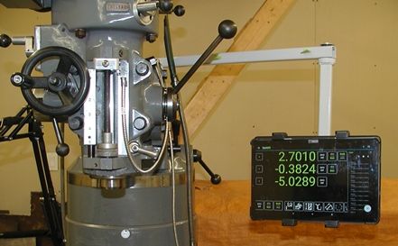

It works! I really like that it gives an uncluttered finish with good access to the depth stop assembly and no mods to the machine.
I like it a lot! It's very clean! If I even do mine over, I would copy your design.
The only thing I'd do different is to flip your sensor so the cable goes up instead of down. It's relatively easy to make it track which avoids a lot of cable problems with the cable hanging down.
Very similar to mine except my read head is mounted 180 degrees to yours.
Thanks for the feedback.
I looked at that, in fact I started with that assumption as well. I mounted the head both ways to try it and decided that I liked the cable behavior better with it down. If you set it in a loop down and right back up and along the ram then it travels well and does not hang down anywhere near a tool path. As you lower the quill, the loop only travels half the distance so it gets further from the tool as you go. I eyeballed it and decided that it wouldn't be in the way for me.
With the cable up I would need to position the head further to the right and toward the front for the exit fitting to clear the castings plus the cable bumps into the castings etc. and quill feed control above as the quill is cycled.
I have routing tie-downs to do with all the cables once everything is mounted.
YMMV of course so yours is up to you. ;)

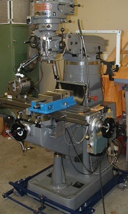

Update: First Mill DRO Installation Wrap-Up.
Z scale mount - After looking at what others have done on machines like this with column surfaces that are inconveniently tapered/contoured, I decided to mount the Z scale on a piece of bar stock supported by a couple of adjustable posts threaded into the column. That still allowed for fine adjustment on scale installation.
Beyond that a few pieces of angle & channel make the connection between the knee and the read head. Works well so far.

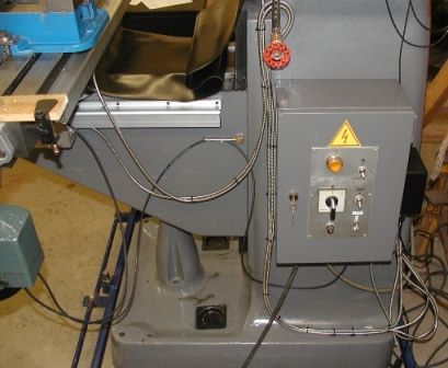

The cables from the scales are rather bulky so I wanted to do something with to get them out of the way as much as possible, I resorted to stick on pads designed to accept Ty-wraps. The big thing was to position the cables so they didn't snag throughout the travel of all the axes. I’m fairly satisfied with with the result except the birds nest at the back but the cable runs aren’t all the same length. It’s all good if the pads don’t fall off, LOL!
The DRO display uses the same Lenovo tablet as my lathe but for the mill I bought a quick change mount on AliEx and brewed up an arm to support it. The arm swings on a mount I machined to fit the “lift” point on the ram and the there’s a swivel on the vertical that the tablet mount is attached to. The tablet mount allows landscape or portrait positions and it has a ball & socket for quick adjustment.
That pretty much wraps up the DRO install. One final thought; it has definitely changed the way I work, for the better!

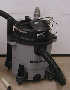

I got the bug for a bucket head shop vac a while back after seeing the discussion @DavidR8 started in his Shop Shenanigans thread (HERE). After seeing mixed feedback about the Home Depot vac I got thinking about what other options I might have. What I came up with was a regular shop vac plus a bucket cover that I could switch from bucket to bucket when I switch material. I wanted a vac for the detached shop anyway so I wouldn’t have to drag the one from the basement back and forth.
The other day one popped up on Kijiji for all of $30. It looks like this:
45l and 6HP if you believe the marketing copy. :p

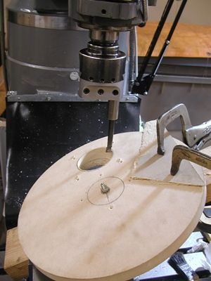

I knocked out a cover from some scrap material and a couple of fittings from Lee valley, cost me about $10 and I even gave the mill quill feed a bit of exercise boring the holes. I could have bought a cover from BB for about $38 all in but it was more fun making my own and besides, it’s greener than a plastic one!
Since this is a machining forum I might as well throw in a picture of boring one of the ports. When you have a mill everything you do needs a mill.....;)

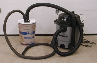

Finished it looks like this:
I’m pleased with the result. It works well, very few of the chips make it to the vac itself.

It looks like you tried to get a bit of a vortex going. Did that work?

I’m not sure what you mean about screw on adapters. The fittings from Lee Valley I used are sized and tapered to fit typical 2-1/4” shop vac hoses. I use a smaller hose with a 2-1/4 end to get faster flow velocity on the pick up though.
I picked that angled fitting (~25* angle) with the idea that it’d put some spin on the flow and that I’d add a deflector if I wasn’t happy with how much material passed through into the vac. It’s not the vortex that I get with the Dust Deputy I use with my sandblaster but so far it’s looking good. It seems to deposit small chips in a pile in a straight shot from the fitting.
I have to say that it makes cleaning up the mill a lot quicker and does a better job than by hand. I wonder if I can rig up a mount so it follows the cutting tool…..

The (tapered) adapters were the perfect solution and surprisingly inexpensive (made in Taiwan) considering pretty much any shop vac accessory seems to be made of gold these days.
Just a random thought or two if you’re going to make one. I happened to have a piece of sawdust board (AKA MDF) the right size for the top disc. In hindsight it was a good choice because I didn’t need to bother sealing the fittings and for the first trial I didn’t even use a gasket at the bucket face and it seemed to seal OK. I eventually made a gasket out of truck cap foam tape. For the other part I made a disc that fit in the mouth of the bucket to centre the cap.
Pretty simple all told and if you bore the cover on the mill like I did you can tell your other half that the mill paid off again! ;)
