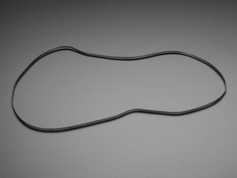

I picture a toothed belt, three rollers, and a tensioning device. Something like the photo, but with the belt coming off the lower left hand roller extending to the left, rather than the right as in the photo.
a 20-tooth pulley is about 15mm in diameter for a 2mm pitch belt, with 1000 pulses per rev the resolution is probably pretty good.
Attach the roller assembly to the machine base, anchor the belt ends to the extremes of the ram.
As long as the belt and roller orientation covers the full possible movement of the ram then all you’re dealing with is relative movement rather than absolute start stop points.
With some math & programming this could give you fpm as well as stroke length
