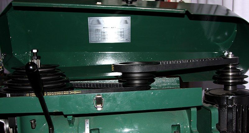

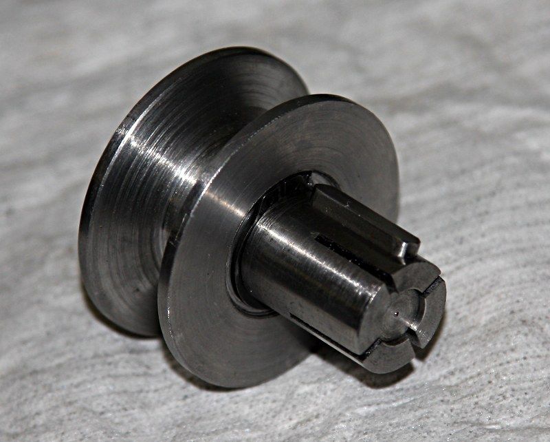

I made a pulley that would fit into the top of the cone pulley on the motor to give me a slower speed
160 rpm the lowest with the factory setup was 270 rpm.

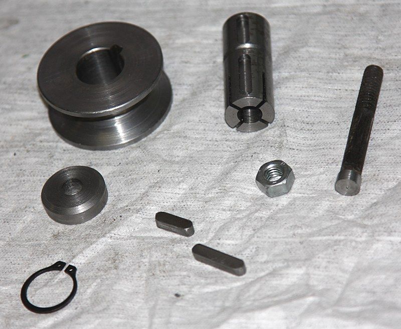

Assemble these parts.

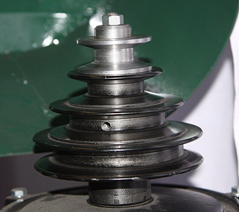

You will have this.
Slide it into the cone pulley and tighten the nut.
A shorter belt was required.

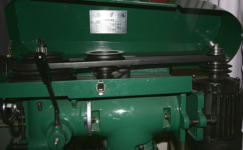

There is a wide space in the speeds in the middle between 490 rpm to 950 rpm.
By running a belt directly from the motor to the spindle pulley I was able to get 660 rpm.
Very nice work. What did you do to align the new motor pulley groove to the existing idler top pulley?
The cone pulley was bored and had a key-way all the way through.
It just slid in and the expanding shaft holds it tight.
The motor pulley on our machines has a blind bore with keyway. Something to keep in mind here.
You could always bore all the way through and extend the key way - if there is enough material on the step pulley.
