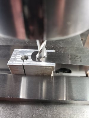

For the mill I use a 0.0005 shim stock to touch of cutters and depending on a axis (x&y or z) compensate to zero as required for the tool. Based on my machines play 0.005 is more than sufficient to be considered a zero value. If I really want to be specific I can even zero that number out as well. Since its steel and not paper it is thinner and more consistent.
I do that shim stock technique on my mill too. Mostly to protect the edge of carbide if contacting hard material. I can just see fracturing an edge with any inadvertent down force. Safer to place some 0.005" brass shim on the surface, contact the end mill, lock the spindle, enter DRO offset same 0.005" amount, away we go.
