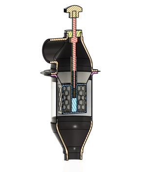

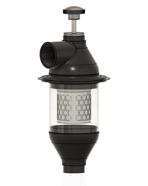

I'm thinking of redesigning this as a round tube so I can have a clear acrylic body to see the mechanism in operation.... to aid in adjusting the force of the snap and de-caking operation.

Sometimes you just have to play with such ideas to see how they work and how to improve them. The so called proof of concept and development process.
If (a very big if) there is a flaw in the idea, I suspect it is in the inertia of the vacuum system airflow and the blower fan. The combination of these two factors may not allow for the rapid release you envision. You may need some kind of mechanism that changes the release speed vs the apply speed like a shaper does, or a triggered system that traps vacuum and then releases it suddenly.
Of course, the only real way to find out is to build a testing prototype and test it!

I expect that in order to get the rapid release the vacuum motor has to brake rapidly.... the spring has about ~15 pounds of force, depending on how much it will be compressed in operation.
But no matter, my design has a minor tweak to make it manually operated just in case.
What I want to see is the static pressure and velocity drop from different filter media with the same area of filter material.
I'll sacrifice some filter efficiency to maintain higher flows if necessary.
