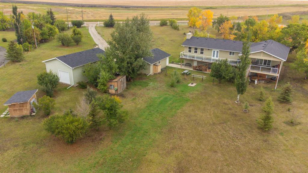

https://www.realtor.ca/real-estate/26095215/283147-township-road-231-rural-rocky-view-county
Big house, big shop, and a garage, on 2 hectares of land. $1.2 Million.
