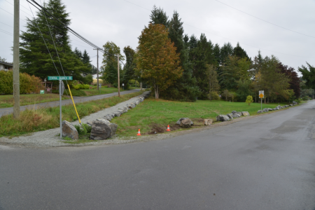

Looks very effective for 'drive by brail' boulevard encroachers. Contact there would not likely 'just buff out'.

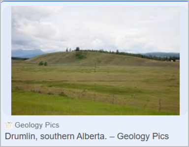

We have a lot of interesting drumlins just outside Calgary sticking up in the middle of another wise flat field. The name is derived from the Gaelic word druim (“rounded hill,” or “mound”). I've seen some from the air that look patterned, almost 'alien'. They are remnants of relatively recent glacial melt. I think Cow Town was buried under 1.5km of ice only 22,000 years ago. But there was a particular animal species that smoked heavily, CO2 levels rose & well... you can see consequences. <insert smartass emoji>

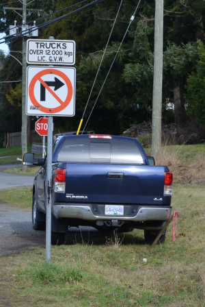

Here's a few years later. A drunk driver couldn't decide if he should go straight or go left up the hill so he split the difference. Vehicle was high centered on one of the rocks. And you can see the grass and weeds are starting to look more natural.

One of the reasons we did the landscaping. To avoid people parking in our yard among other things.
It used to be a ditch but was filled in when a new subdivision was added further down the road and they then brought sewer and storm drains along our property. Still took a few years before I got rid of the septic field.

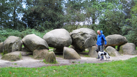

As far as rocks go this is a Hunebed (#D27) in Drenthe, The Netherlands. We visited that with Anja when we took her back for her 1 year puppy show.
I have some large boulders that I'd like to set up something like this on the corner. The Hunebed were grave sites. This is where we'd like to put all our doggy ashes.

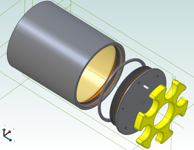

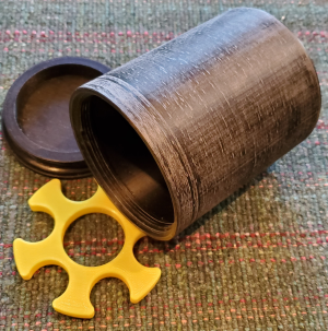

So here's where I am on this:
The yellow handle is Generic PLA, the little alignment drive pin is a finishing nail turned down on my little Unimat DB200. The pins are glued into yellow handle. The lid and body are Bambu PETG HG and the ORing is TPU.
Pitch on the threads is 2mm. I think the TPU Oring is still too hard to great a decent gasket seal. It leaks and if I really reef on the handle to tighten it I then have trouble getting it loose again.
Overall size of the body is 100mm x 120mm long. With the gasket in place (4mm diameter) the overall size if 126mm long. I'd post a photo but it's all black PETG and black TPU so doesn't really photograph well.
Overall the surface finish isn't bad but the slightly softer PETG doens't sand as well as PLA and although after a few cycles the lid threads smoothly into the body once it tightens it sticks because of the rough finish on the threads. I also used random seams so there wouldn't be a thick bump on the threads or mating surfaces.
Not sure what the next step should be. Maybe a real ORing?
