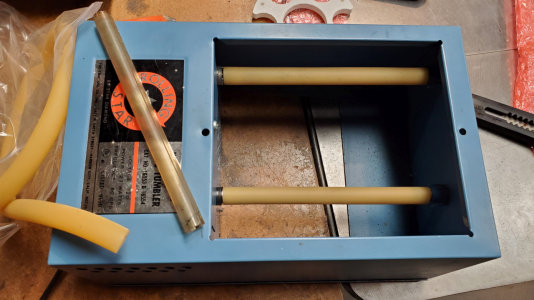

Would 3 or 4 (or 10) fattish orings on the shaft give enough friction?
Possibly. But they might also walk (crawl?) over to one end over time. I've read it can take two weeks 24/7 to do the initial roughing with coarse grit.
Now fat Orings with 3D printed spacers would work perhaps. But then at the moment I'm expecting tubing via Amazon sometime today. Try that first.

Make a drum from large diameter rad hose? Or something similar? Then, the heavier the load, the more it presses into the drive rollers? Probably easy enough to make some caps for it...
Just looking at the replacement parts, they all seem to be rubber or rubber lined. Must be something to it. You could probably glue in sheet neoprene or whatever. Or maybe 3D printers can squirt soft durometer stuff like this?
TPU could work. Not sure if it would be durable enough.

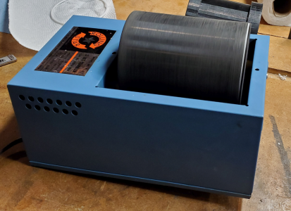

Amazon was here this evening. Took only minutes to slice the hard plastic and push the new rubber over the shafts.
Works great even with a full load of rocks. However since the soft tube had to be pushed on and it tends to compress a bit it's perhaps thicker at one end or the other. What happens is the drum migrates towards the right side. Have to prop it up to have it stay centered.
The old plastic covers had the drum migrate to the left but much much slower.
I think those two holes on the top could be used to mount some sort of roller that keeps the drum centered. After a few minutes of turning the inside of the drum was very dusty.
The TPU also arrived. need to work out parameters for printing as what the Bambu selects for TPU doesn't match the instructions on the outside of the reel. Then I can make a new gasket and hopefully be able to make the tub watertight.
And yes, seems the biggest thing is lining the inside of the tub with rubber as much to prevent erosion of the drum interior but also to reduce noise.

The lid on my Lortone tumbler drum had a knob with a groove around the circumference that rides in a small bracket with a cutout for the knob to ride in. Located near where that hole is on the motor side.

My wife has four little Loratone tumblers and an old large one. https://rocktumbler.com/ like his Model "B". Those drums are an industrial standard . We were given one and I made a tumbler for my rifle brass, copying and improving the old one . I had repaired and improved my wife's before so I had a pretty good idea. I used 1/2" heater hose on the shafts. I put identical pulleys on the two shafts so as to drive with both. The heater hose wears out, but is easily replaced. My tumbler works for an hour once in a blue moon, hers goes for months on end.
