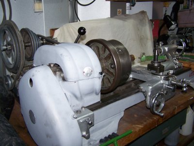

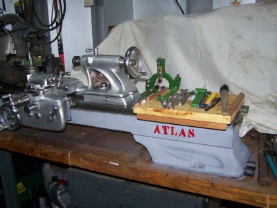

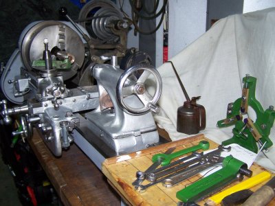

Finished the epoxy repair on the cross feed gear that needed a key. I used a hacksaw blade to saw grooves on each side of what remained of the key, then pressed in some Loctite epoxy, then filed for ever to size. Looks to me that it may work for a while. ......................................Daniel
